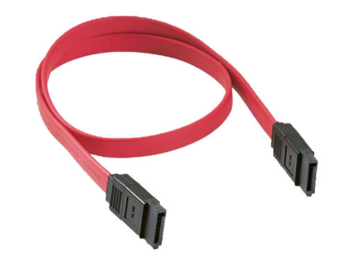

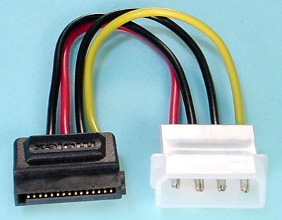

You will need a standard SATA cable for data and 4 pin molex to SATA power cable to power it.
You will get SATA power from this adapter:
SATA data - cable you need to connect to one of those ports on the picture above and the other side to your DVD.
