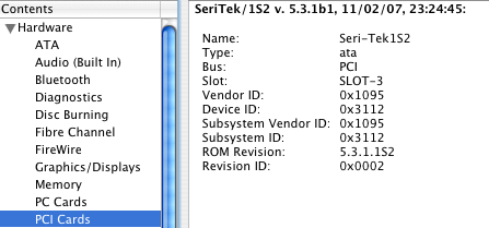

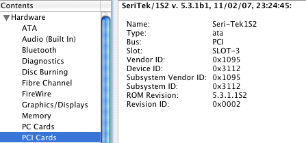

FYI: Sonnet gets FirmTek to make their SATA cards and from experience I can say they are the absolute best out there. Good investment. The 5.1.3 version of the firmware is recommended for G4 towers. With that firmware even sleep will work fine. Check what it currently has in system profiler.
Correct, I do not have much experience. I did get it to work, and made a clone of my drive before I created the RAID. Seems a little quicker.
Handbrake rips at about 7.5FPS if I don't have Safari open. I keep all my important stuff on other drives. And have copies of everything on all three drives that are in my computer. I need to burn some stuff to DVDs.

About your firmware version. You have 5.3.1 and that is the worst version to run on G4 towers. 5.1.3 is highly recommended for G4 towers. You can verify that by emailing their support staff. 5.3.1 is intended more for G5 towers with standard PCI but because it's the newest version it comes as the default on their cards. I was told to downgrade when I had sleep and other issues.
Here is a link to the better firmware: http://www.firmtek.com/download/SeriTek1S2_513.zip

I haven't really had any problems with the SATA card. I'm doing handbrake rips right now or I would down grade the card.
