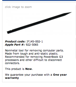

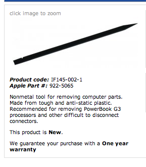

What's a spudger?

It's a plastic pen type thing you use to lift up/disconnect the data ribbon from the keyboard,waist of money ( i used my gf's fingernail )
