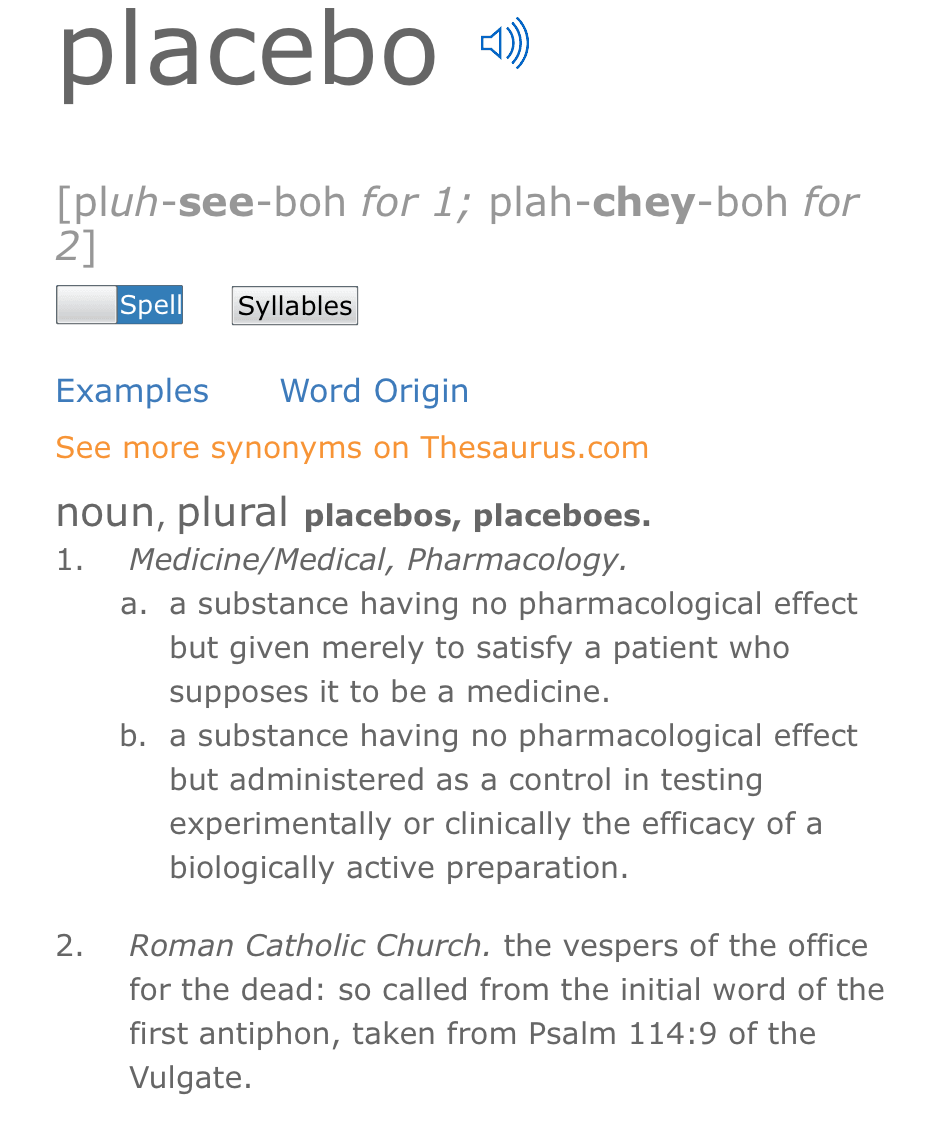

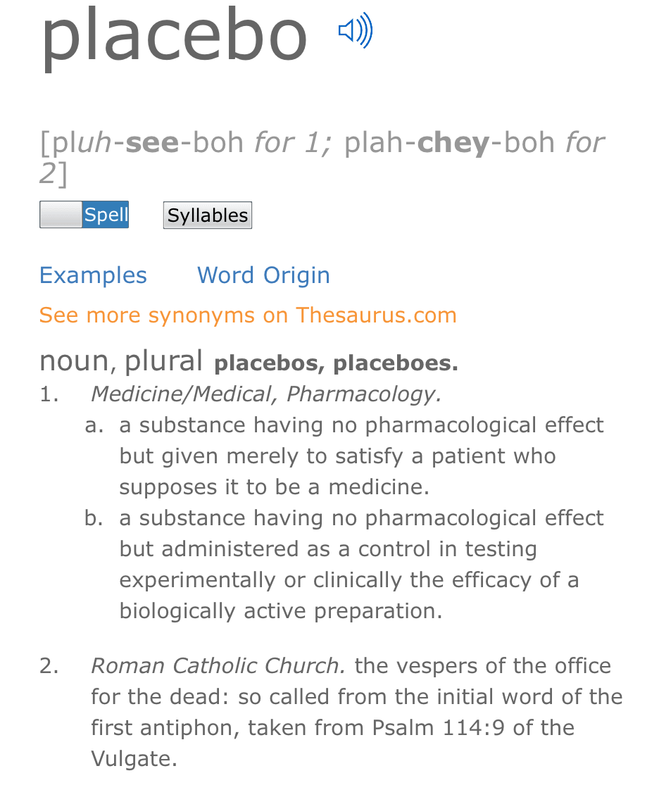

A placebo as defined by dictionary.com:
The PCI-e SSDs give real world performance benefits and are most definitely NOT a placebo.
