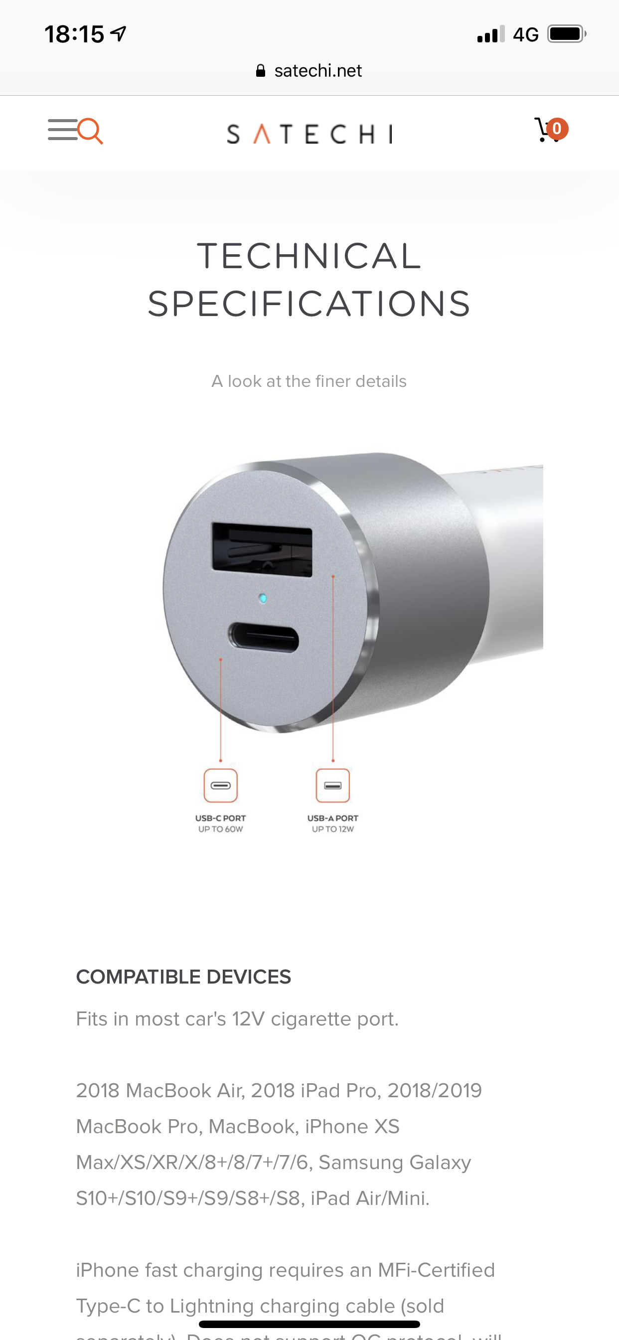

I have the Anker 42w cig charger
https://www.amazon.com/gp/product/B07H4M4N5V/
It seems to charge my 2019 Macbook 13" and keeps it topped up at 100%. I did notice that when I used my inverter and 60w macbook ac charger the tip of the inverter plug that attached to cig lighter was really hot. I think that the inverter is probably worse for battery since it converters dc to ac charger to dc whereas usb c just skips the middle part.
is charging at lower amp bad for laptop?
anker specs:
Input: 12V / 24V==5A;
USB C Output: 5V==3A / 9V==3A / 15V==2A / 20V==1.5A;
USB A Output: 5V==2.4A Max;
