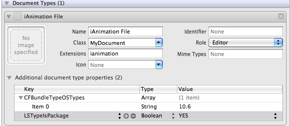

Here is an image of my document types settings, because I changed some stuff here without knowing what im doing, hopefully this will provide some clues about what's wrong:
Any idea?
Thanks 🙂
Perhaps the easiest methods for saving and loading files is in binary plist format. To do this, you implement -dataOfType:error: (saving) and -readFromData😱fType:error: (opening). Here you would use NSKeyed(Un)Archiver to create or decode your file, typically using the class method with "root" in the name.
Your document should be a tree of objects that recursively encode/decode each other: to do this, you need to implement NSCoding protocol in every object that will be saved in the tree so that every -encodeWithCoder: method has a matching -initWithCoder: method and everything you need to save will be in the archive tree.
Archiving docs
The program no longer gives me an error when the user clicks Save.
