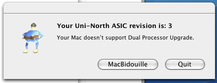

Here's a link to an app which will check the uni-n version of your Sawtooth.
https://www.dropbox.com/sh/pwvdvxfaxzt89bd/EjZ7P9AVlW
Thanks for the link, I will need to put the sawtooth back togethrt to check it out.

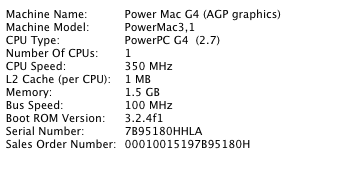

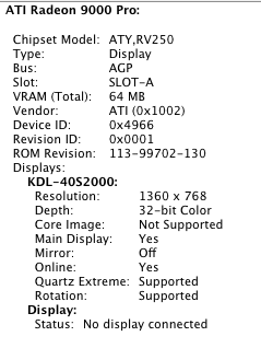

Here's what I have so far. Each of my DA733Mhz had a single 512MB stick in them, I swapped them for a pair of 256, and stuck the three dimms in the sawtooth. Laying around I have a DP533 and a SP733 out of a DA. I couldn't get the Radeon 9800 in there, cause the card physically wouldn't fit.
