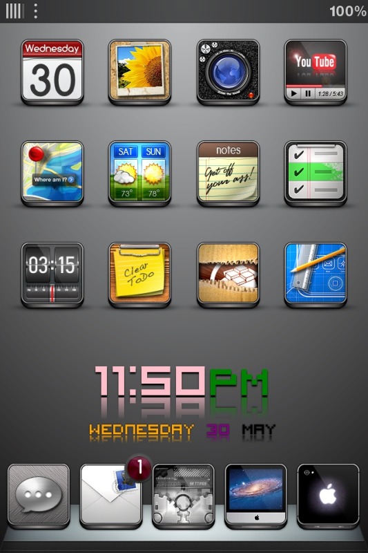

Hey guys, I really want this tweak, to get a theme similar to:
The problem is, when I use SB Clock Reflect the wallpaper is always black, and I can't set my own. In fact the only time I can is when I use a theme with a wallpaper of it's own. But even that means I can't change it, because when I go into iFile and change the wallpaper for that theme manually, the resolution and scale goes all crazy... Help? Has anybody else had this problem?

Basically I would like a customisable Wallpaper with the Suave theme, and the SB Clock Reflect tweak as seem in the picture...
Also this is a bit off topic but, does anybody know how to get the status bar like in the picture too and how to change the colours of SB clock reflect? Thanks!

Add your wallpaper to the theme folder, it has to be 640x960, and name it exactly Wallpaper.png.
To change the colors of the date/time, just edit the Style.css in the same folder. You should see what to change when you open it up.
