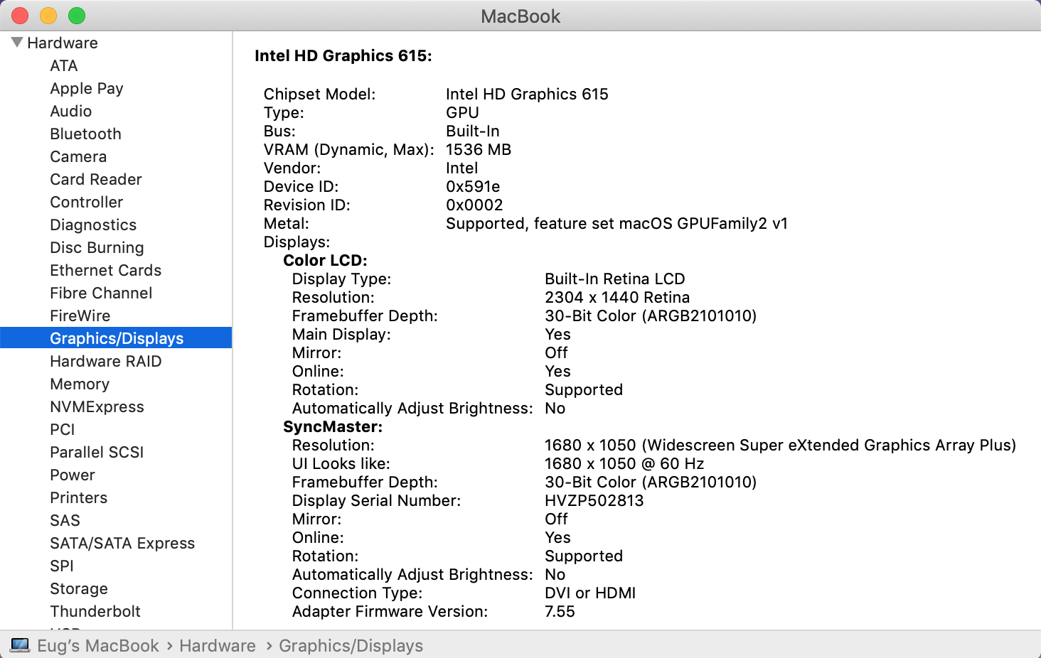

I think the battery life dropped after scaling to 1680x1050. Which is kinda expected since the hardware is working harder.
There is always a powerbank in my bag, so the reduced lifespan can be overcome.
I was wondering what the big deal was since this machine displays 1680x1050 just fine on external monitors. No lag.
Then I realized you were talking about the internal screen. Doh!
