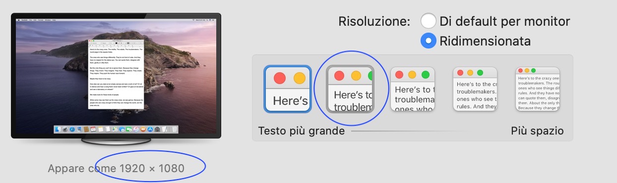

I just bought a DELL U2720Q 4K. Tried at 3840x2160 but it's too small so I scaled it down to 2560x1440 and it goes well, no slow.
After I shutdown and turn on the monitor, it was back to 1920x1080, strange. so I'm going to rescaled but now I noticed that hovering the first option now it doesn't show dock and window in the preview on the left, neither the resolution 1920x1080 as it shown before.
Here, hovering first option:
Hovering second option now it show the 1920x1080, and third one the 2560x1440. So it seems all the options are translated.
Then, I rescaled to 2560x1440 (third option, while before was the second one) and now it's slower than before. And I can't get it back to works as before without lags. I especially notice the slowness when scrolling webpages, moving cursor, dragging windows, ...
You know what's happened?

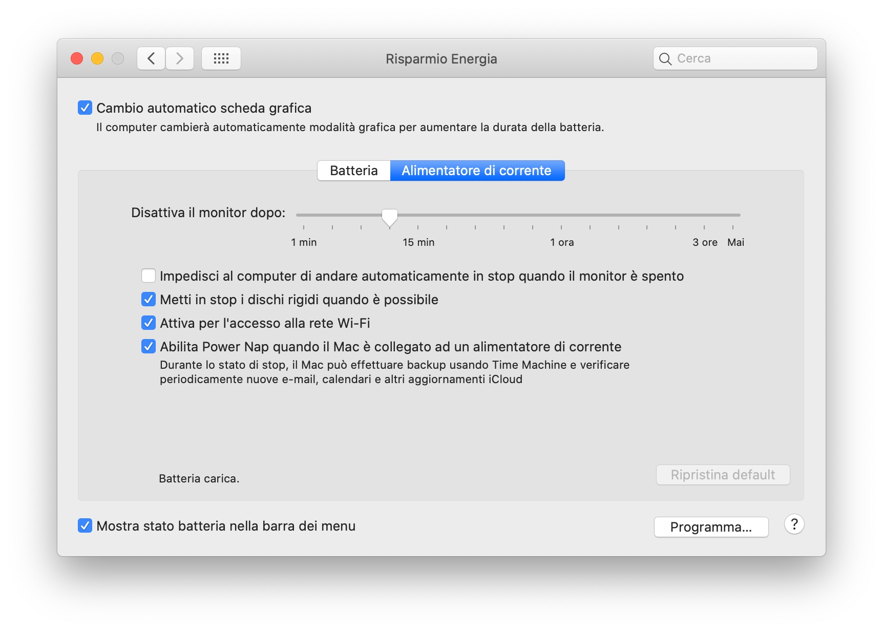

I would expect the Radeon Pro to handle this very well! I was expecting a Mac Mini with Intel graphics only. Do you have the Radeon turned off via performance settings perhaps? Does this behaviour persist after a reboot?
The very first checkbox on the page can stop the switching on battery. I'd try turning that off. Otherwise has anything changed since it worked well? Software updates? Any software installs?
@robbieduncan tried to turn off but frankly it's the same. 🙁
Nothing changed! Today I just turn off and turned on the monitor and yesterday worked well!

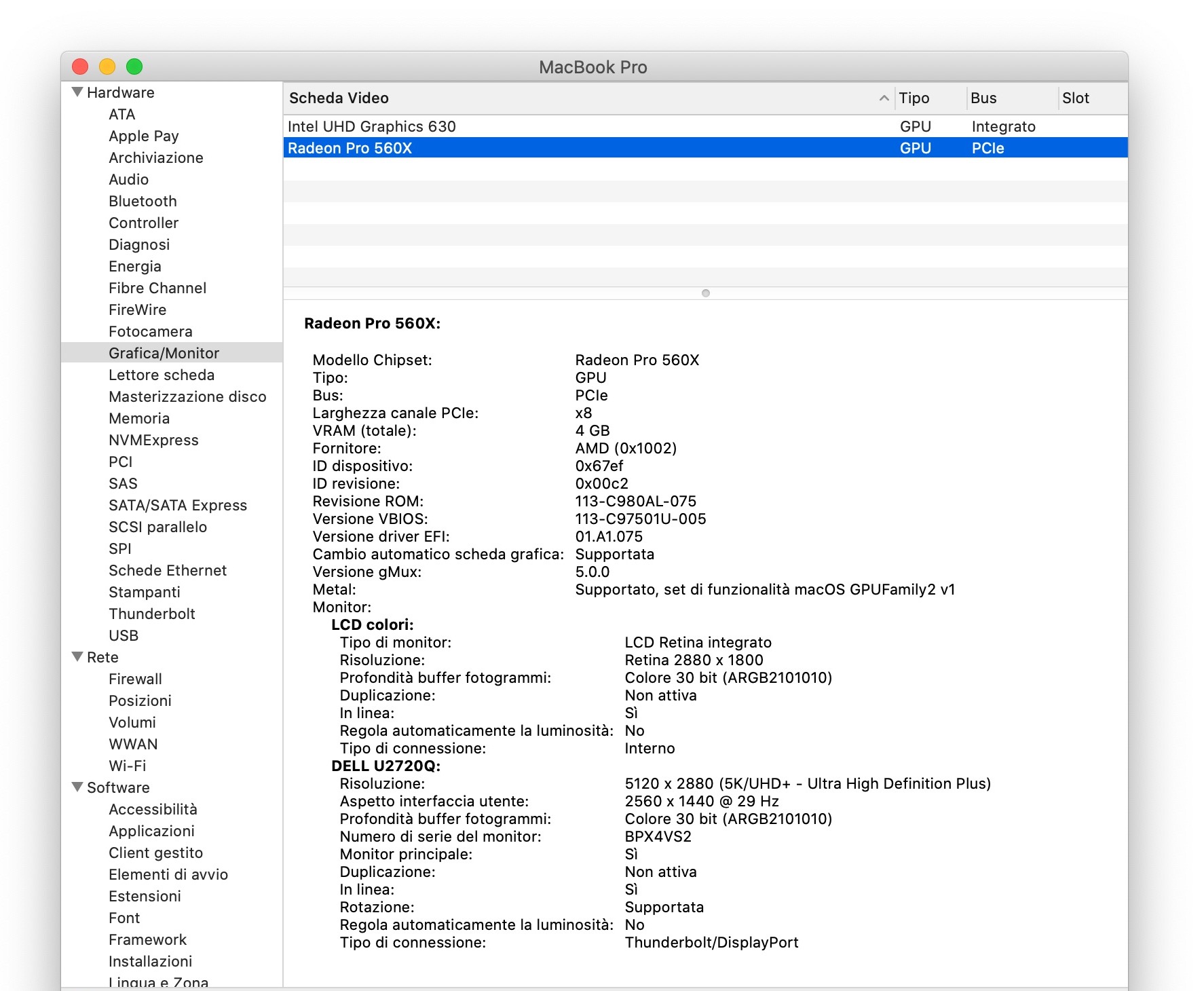

There is some strange things in there. Why is it only connecting at 29Hz? Do you have a second cable you can try? I have 2x4k displays connected and I see both connected at 60Hz (as expected). Also why is your GPU only connecting on a x8 bus? I would expect x16 although I do not expect this makes any real difference. What OS version are you running?
Well @robbieduncan,
Why 29Hz? I really don't know!
Also why is your GPU only connecting on a x8 bus? => Really don't know what it means
OS version: macOS Catalina 10.15.4
I'm using the USB-C-->USB-C cable included with the monitor. I can try another cable DP-->USB-C. Anyway the monitor at some point worked well and I was using the USB-C-->USB-C cable.
Note: USB-C-->USB-C cable works also for recharging the Mac, so I don't use the Mac adapter but just that cable

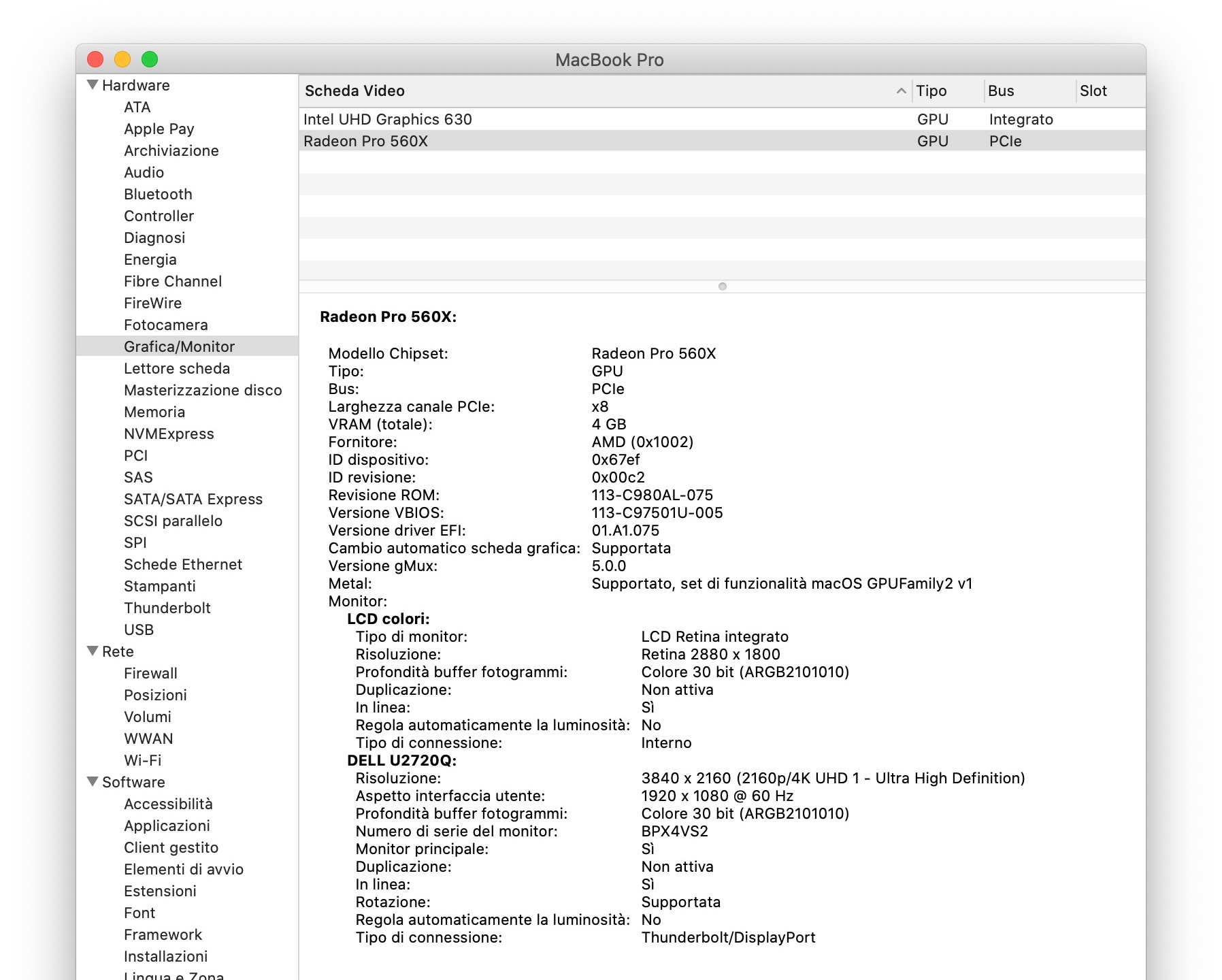

@robbieduncan I tried with another cable, it's a DP-->USB-C cable and now it' a lot more reactive and fluid.

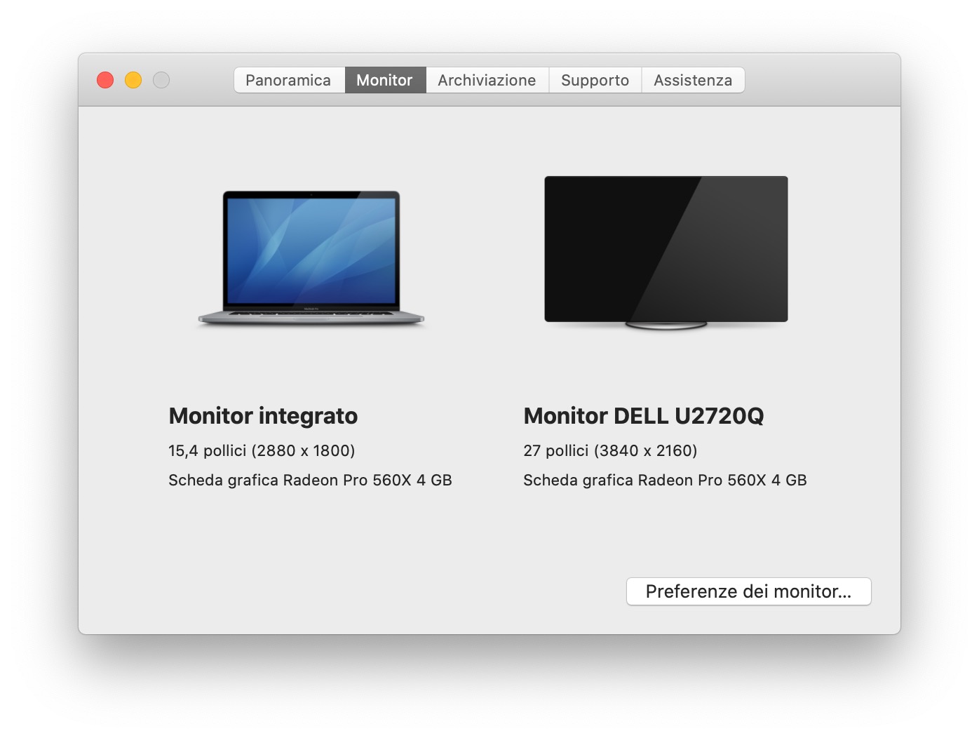

Here the screen:
Is it all okay at your eyes now?
To me there's something strange yet. Check how changed these details:
With USB-C-->USB-C cable
Risoluzione: 5120 x 2880 (5K UHD+ - Ultra High Definition Plus)
Aspetto interfaccia utente: 2560 x 1440 @ 29 Hz
With DP-->USB-C cable
Risoluzione: 3840 x 2160 (2160p/4K UHD 1 - Ultra High Definition)
Aspetto interfaccia utente: 1920 x 1080 @ 60 Hz
With DP-->USB-C cable the monitor is a lot faster but it seems a less defined (or maybe a little little bit blurry).
Possible?

Take a look at these:
Case 1: With USB-C-->USB-C cable
Risoluzione: 5120 x 2880 (5K UHD+ - Ultra High Definition Plus) ==> why 5k? the monitor is 4k
Aspetto interfaccia utente: 2560 x 1440 @ 29 Hz ==> correct choosen resolution but strange Hz... why?
Case 2 (actual): With DP-->USB-C cable
Risoluzione: 3840 x 2160 (2160p/4K UHD 1 - Ultra High Definition) ==> these seems correct, right? it's a 4k monitor
Aspetto interfaccia utente: 1920 x 1080 @ 60 Hz ==> this is strange because I choose 2560x1440, correct? And yet the resolution is very similar (if not equal) to before...
What do you think? Could you check your data? How they are compared to the above ones?

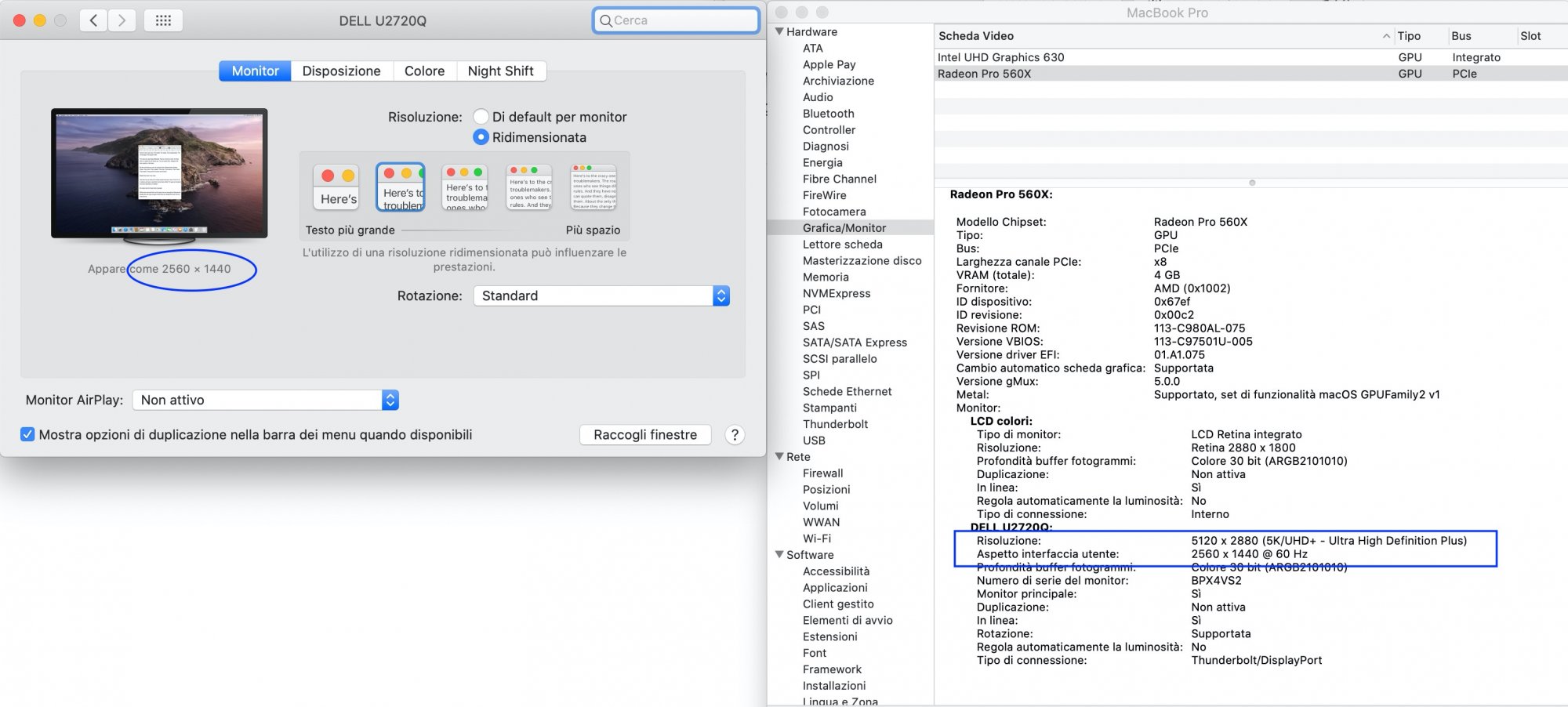

Just now, with the same DP cable, without changing nothing:
SO randomly. 🙁
I this supposed to be the correct data I should have?

I have the same monitor with Vega Pro 20 over USB Type C and System Report shows me
Displays:
DELL U2720Q:
Resolution: 5120 x 2880 (5K/UHD+ - Ultra High Definition Plus)
UI Looks like: 2560 x 1440 @ 60 Hz
Framebuffer Depth: 30-Bit Color (ARGB2101010)
Main Display: Yes
Mirror: Off
Online: Yes
Rotation: Supported
Automatically Adjust Brightness: No
Connection Type: Thunderbolt/DisplayPort
According to Dell's webpage for the monitor in question:
it is a 4K monitor (3840 x 2160), not a 5K monitor.
Thus, connection via USB-C is A.) not connecting at the right frequency and resolution by default, and/or B.) not reporting correctly what the connection is.
I have seen a similar problem in the past using an HDMI cable connecting my Mac mini 2018 to a 27" LG HDR UHD (4K) monitor and the cable did not report the correct connection. I am currently connected via a USB-C cable between the two.

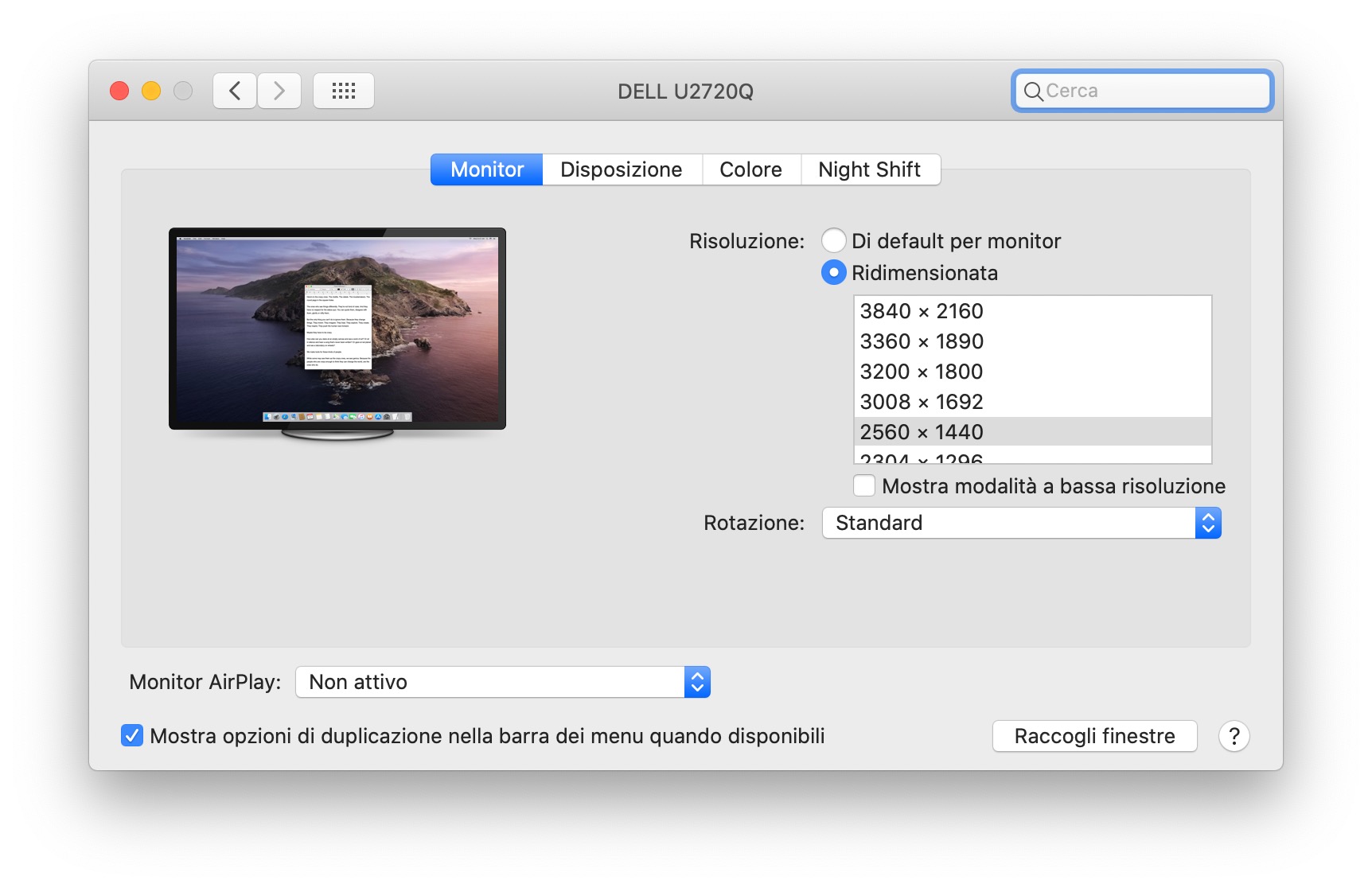

I suggest you try explicitly setting it to 3840 x 2160 resolution. If you press the Option key when you click on "Ridimensionata" you might get frequency options; try 60 Hz. It may be better to select "Di default per monitor" (native resolution).
I have a Mac mini 2018 with integrated graphics driving the LG monitor at 4K @ 60 Hz and your MacBook Pro's discrete graphics are better than mine.
Reactions: macsnack
That! 🙌

It looks like there is a bug in System Information: when changing the 'Scaling' under the display preferences,
it reports weird 'native resolution' values, sometime it shows the display is detected as 5K, sometimes even more.
The monitor always reports that the input resolution is 4K so the mac output is OK scaling only changes the DPI.
Thanks for answering this, @eyalben!What option are you using in Display Settings?
By default, mac uses half the vertical/horizontal resolution - so 4K display will become 2K (1920x1080) with high-DPI.
I am using scaling of 2560x1440 which might cause some performance issue (though I had no issues at all!)
(It is actually renders a 5K image and scales it down to the 4K display).
