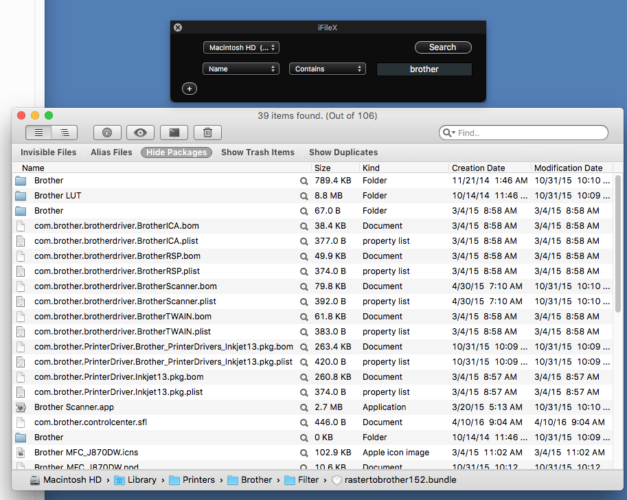

The easiest way is to use something like iFileX to search for Brother and remove everything that way.
You can see my results here. You can do this with Finder also, but you have to mess around changing the default settings to see system files and it is a hassle. I find it easier just to use iFileX for the search.

Thanks for that. I've used iFileX and removed everything with a reference to Brother. I've restarted my mac and reinstalled the drivers for printer and scanner. Unfortunately still not working - for some reason my mac can't see the printer and can't even set it up as a Bonjour printer 🙁
