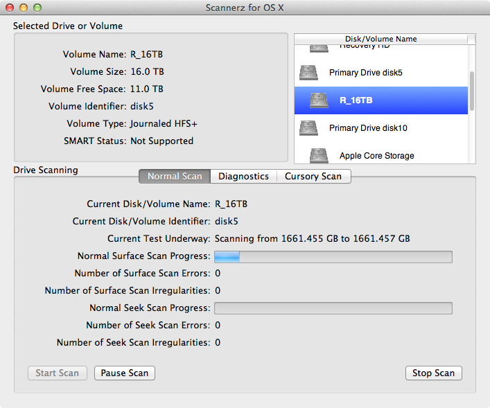

On a different Thunderbolt2 cable/bus I am using Scannerz to do a Normal Scan of another 4-way software RAID. I am using the Activity Monitor to monitor data rates achieved.

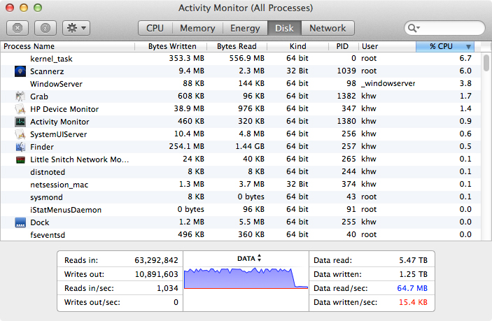

When both the copying window and the Scannerz window are entirely visible I observe these typical data rates:
So, the copying process seems to get about 130-140 MB/s each for read and write operations. That leaves about 60-70 MB/s for Scannerz reading operation. Please, also note that in this case Scannerz uses about 6.1 %CPU activity.

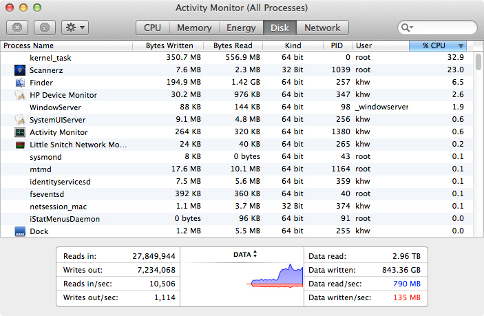

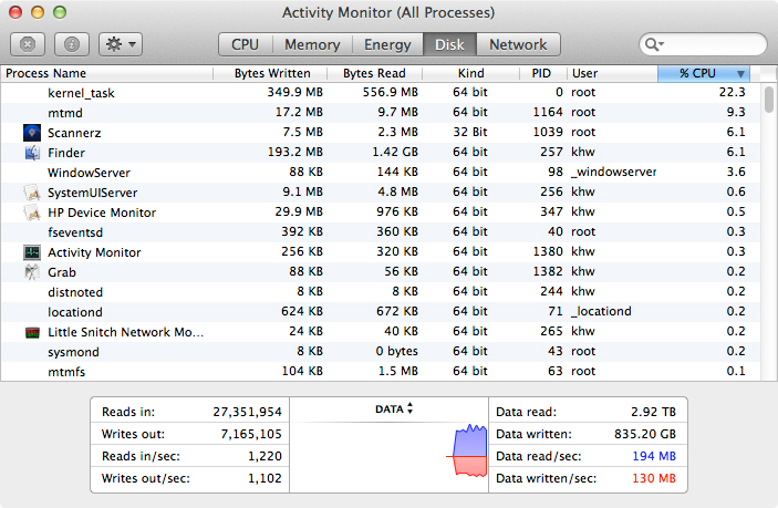

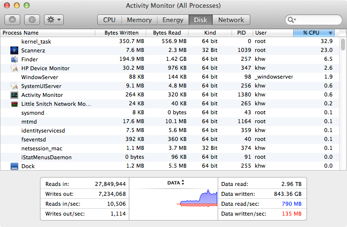

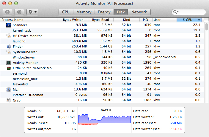

However, when I cover up (almost/completely) the Scannerz window with another window - be it a Finder, BBEdit, or Safari window - then I measure these data rates:
Whereas as expected the write data rate for the copying process stayed roughly the same, the sustained combined read data rate has gone up to typically around 800 MB/s, varying between 600-900 MB/s. So, if we subtract the typical read data rate for the copying process we end up with an estimate of about 650 MB/s sustained for the Scannerz Normal Scan process, which happens to be the typical read data rate I measured for this particular software RAID.
So, that’s about a Tenfold increase in Scannerz scanning speed. A most welcome speed increase indeed!
Please, also note that now the Scannerz CPU utilization has gone up to 23.0 %CPU.
Question: What is the explanation for this? Answer: Could it be that in the covered up case no interrupt is necessary to display the running current scan numbers and the nMP with Mavericks takes advantage of this fact? Here is the Scannerz window:
BTW, the copying process has finished by now and I got these snapshots:

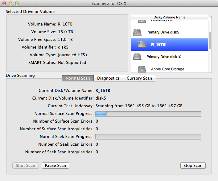

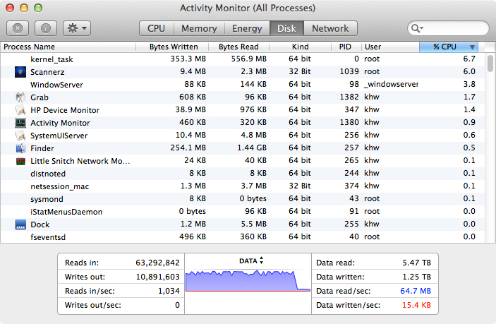

First, Scannerz window fully visible in display:

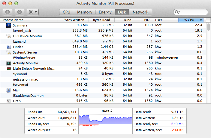

Second, Scannerz window completely covered up in display by another window:
This seems to confirm my previous estimates.
My conclusion - cover up!:
A scanning speed of 65 MB/s makes use of Scannerz impractical for very large RAIDs.
A scanning speed of 650 MB/s makes use of Scannerz practical for very large RAIDs.

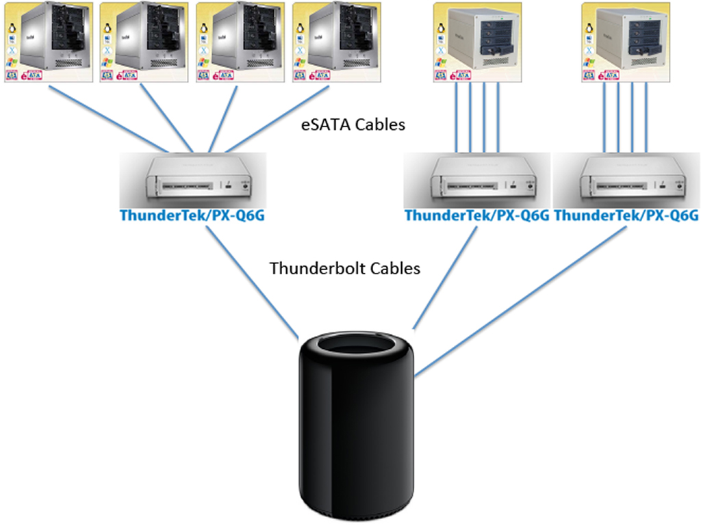

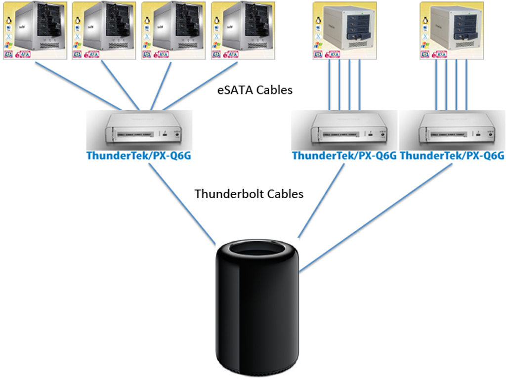

Here is a diagram of my nMP / FirmTek system:
• At the left four SeriTek/5PM Five-Bay Hot-Swap External SATA Port Multiplier (eSATA) Enclosures are attached to the nMP via a single SeriTek/Q6G 4-Port eSATA 6G Storage Adapter.
• At the right two SeriTek/2eEN4 Four-Bay Hot-Swap External eSATA Enclosures are attached with one Adapter each. These two enclosures don't have Port Multiplier functionality and require an eSATA connection for each of their drives.

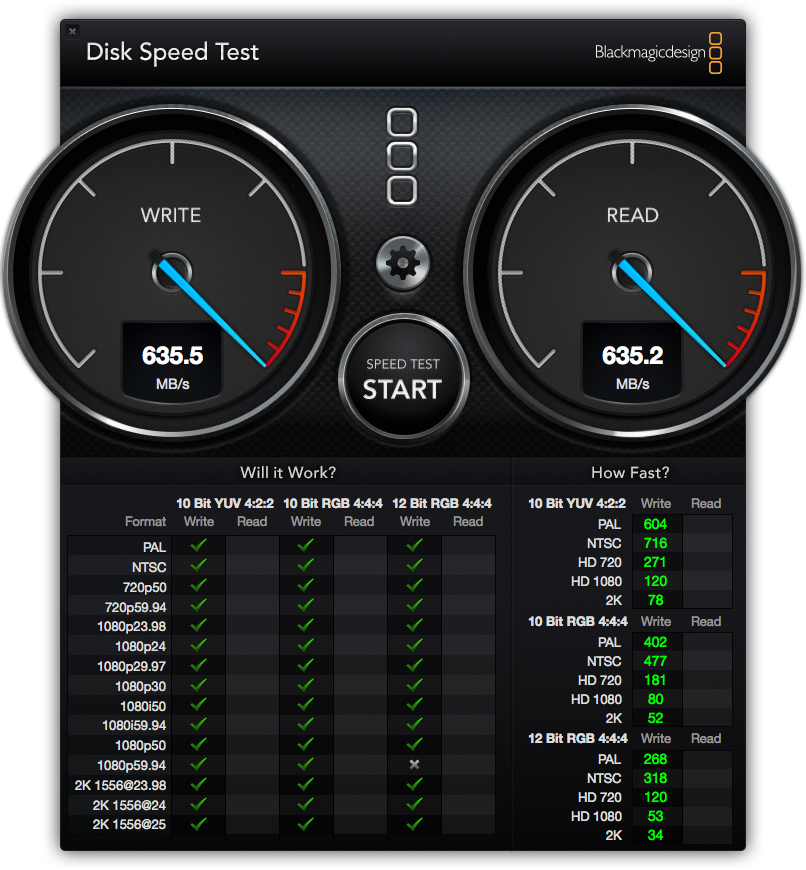

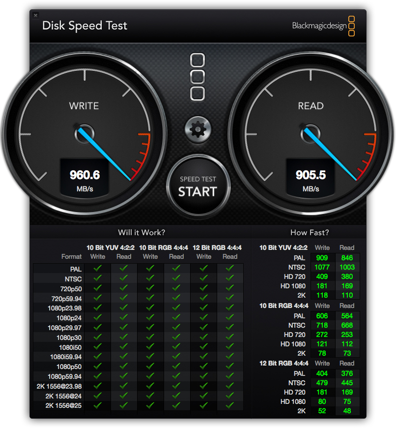

In one of the enclosures to the right I have a 4-way software RAID 0 with Hitachi HGST 4TB Deskstar 3.5" SATA III Internal Desktop Hard Drives. Blackmagic Disk Speed Test gives these performance numbers:

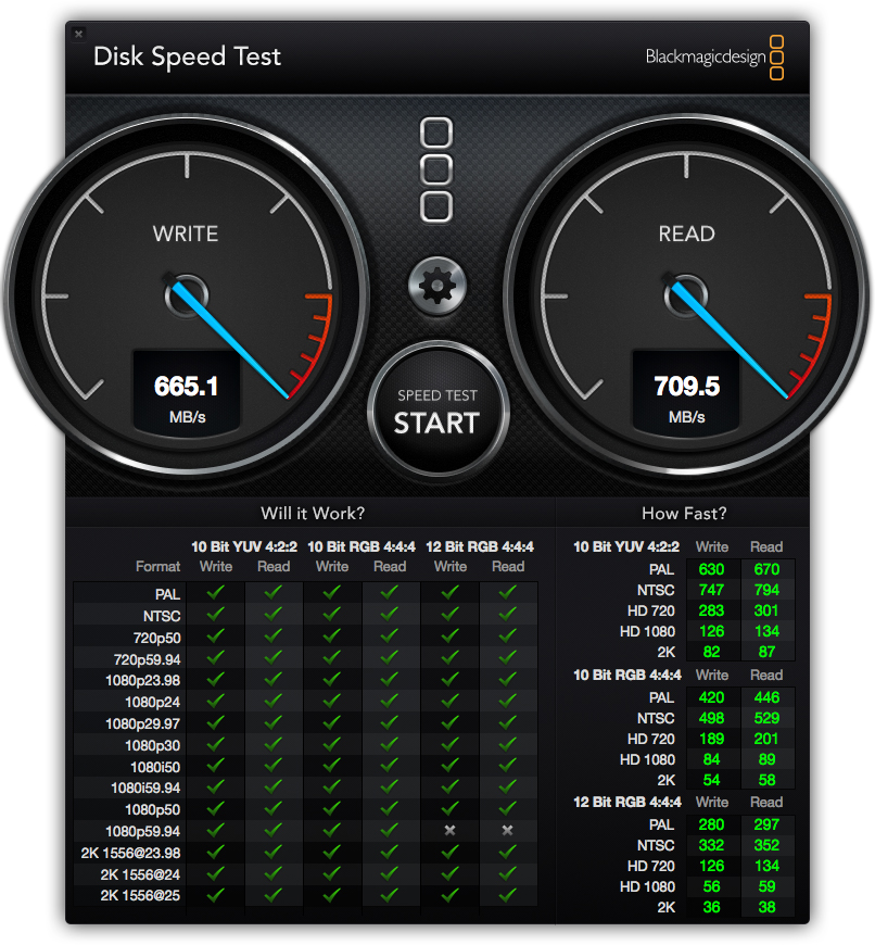

In the other enclosure to the right I have a 4-way software RAID 0 with Crucial 256 GB SSDs. Blackmagic Disk Speed Test gives these performance numbers:

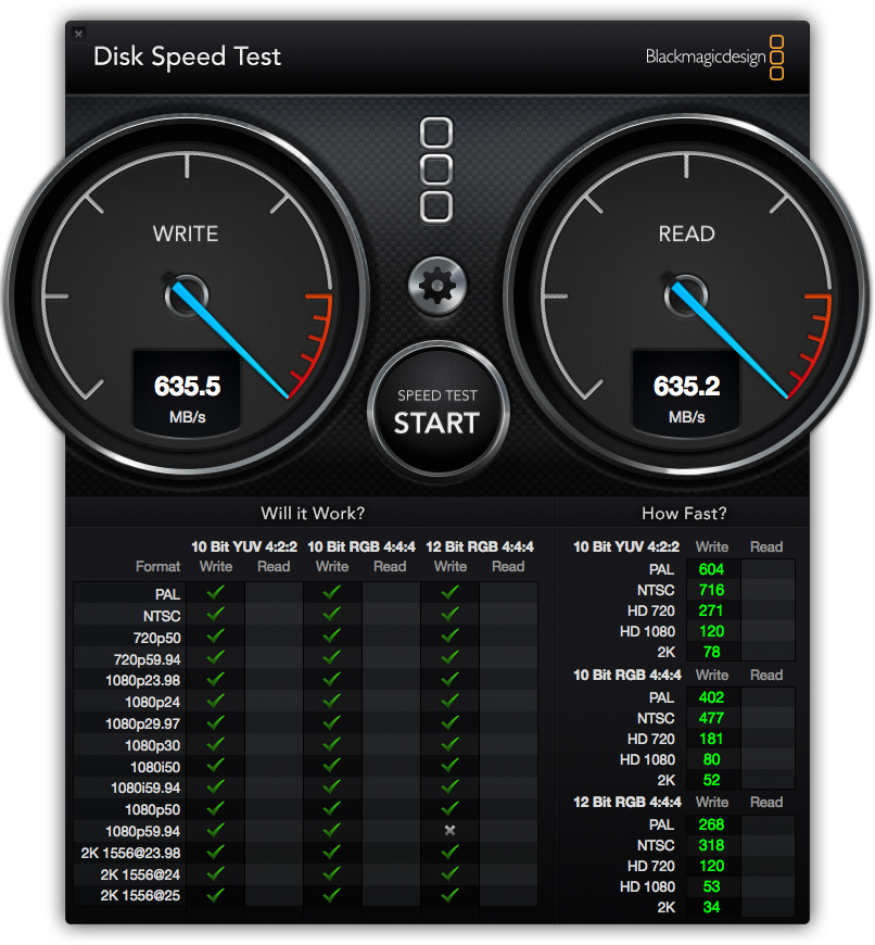

For the nMP internal PCIe-based flash storage Blackmagic Disk Speed Test gives these performance numbers:
This approach gave me the option to continue using my mostly already existing FirmTek gear with the nMP and obtain I/O performance numbers commensurate with my storage needs. The four 5PM enclosures to the left serve mainly as backups.
BTW, each of the SeriTek/Q6G adapters is attached to a different Thunderbolt bus. The four 5PM enclosures share a bus with my 30" ACD. The other two RAID 0 enclosures each have a bus for themselves.
