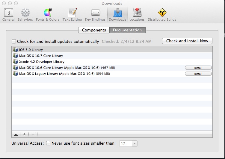

By the way, can I download the docs to my computer or does it allways need to relly on an internet connection?
You can download them. What does your Documentation preferences (under Downloads) in Xcode show?
Here is the window
Wirelessly posted (Mozilla/5.0 (iPhone; CPU iPhone OS 5_0_1 like Mac OS X) AppleWebKit/534.46 (KHTML, like Gecko) Version/5.1 Mobile/9A405 Safari/7534.48.3)
If you do want viewable documentation on your iPhone or iPad, I've found that Apple has made several of them available as iBooks. It seems the rest are available as PDF files which iBooks does quite well at displaying. It's not a replacement for a computer, mind you, but it works great in a pinch.
