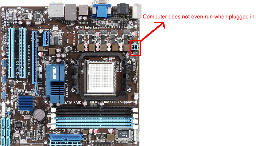

Actually the motherboard is:
http://www.asus.com/Motherboards/AMD_AM3/M4A78LTM/
Asus m4a78lt-m
The cpu fan runs fine.
All the power connectors are connected fine.
The computer will not boot up if I have the 4X 12 volt plugged in,
The computer will only boot up if I have only the 24x 12 volt plugged in.
Example:
I think I will reset the cmos again; hopefully that will work.
