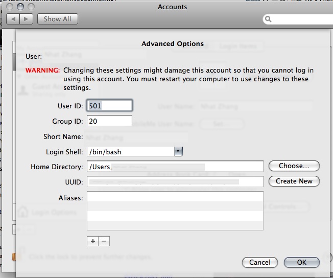

I was wondering if there was someway to run a server like one at a school where applications are on the internal drive, but documents (home folder) are stored on the server and you have to log in with a username and password. I would want to run the server off of a time capsule or an external hard drive attached to it or an airport extreme. Thanks!
Maybe change the location of your home folder to the server.
Just get Mac OS X Server and use Mobile Home Folders.
