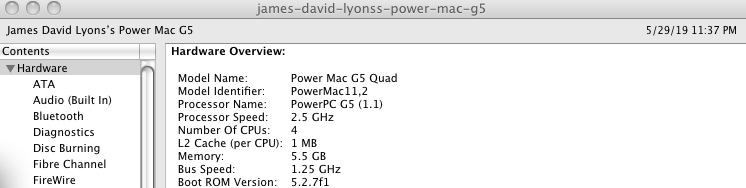

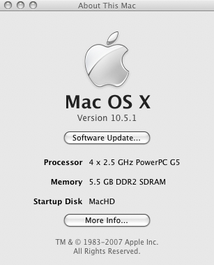

Picked up two 2005 G5's for $80, untested with no power cords.
A little love with some wire, and I got one running, a G5 Quad.
The other DP 2.3Ghz powers on but makes no beeps or bongs, just sits awhile and the fans ramp up.
Not sure the trouble with that one, but I only wanted the quad;-)
Let me know if anyone needs parts for an '05 DP?

I got the Dual 2.3ghz working, bad video card and corrupted NVRAM.
