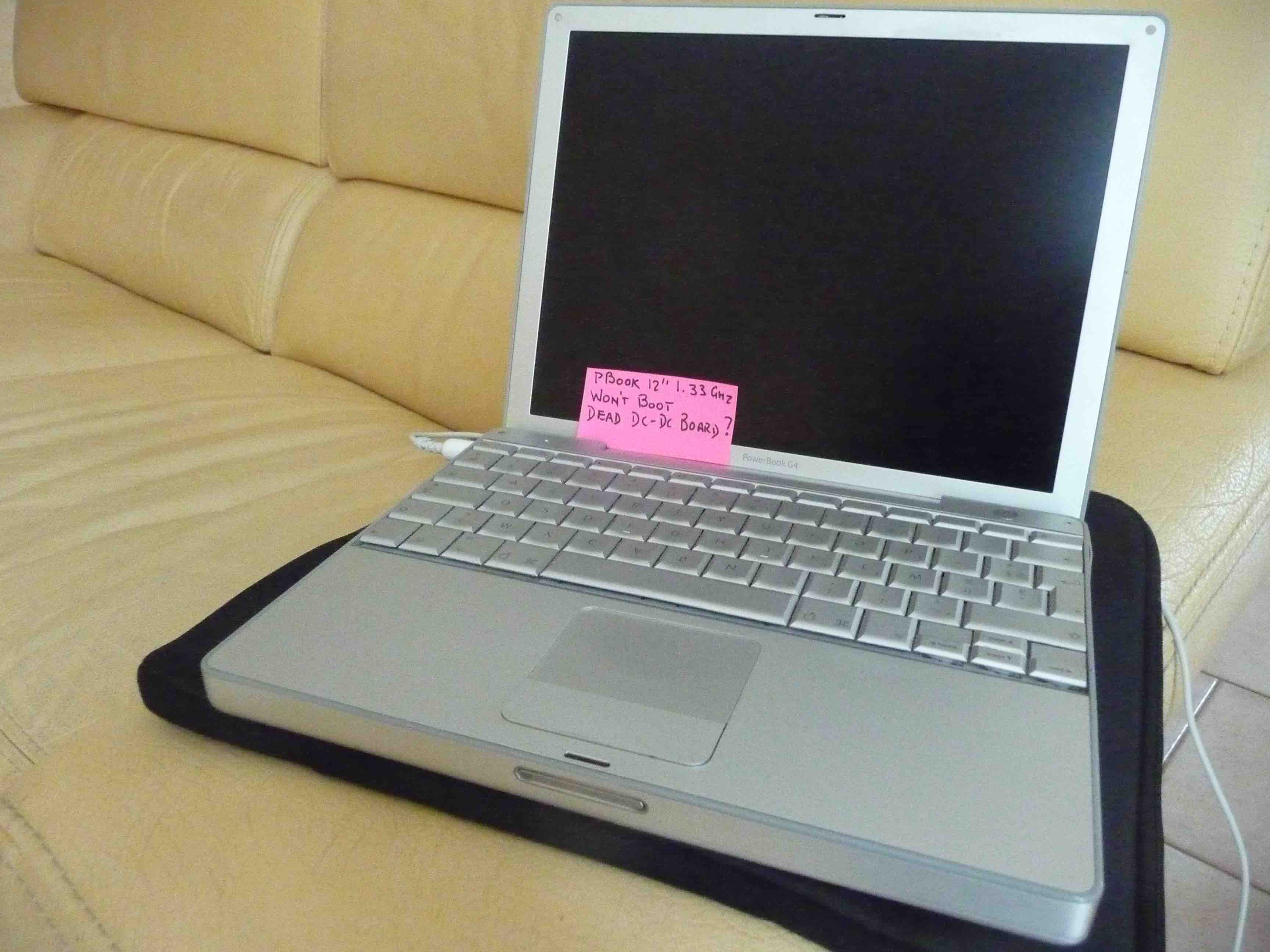

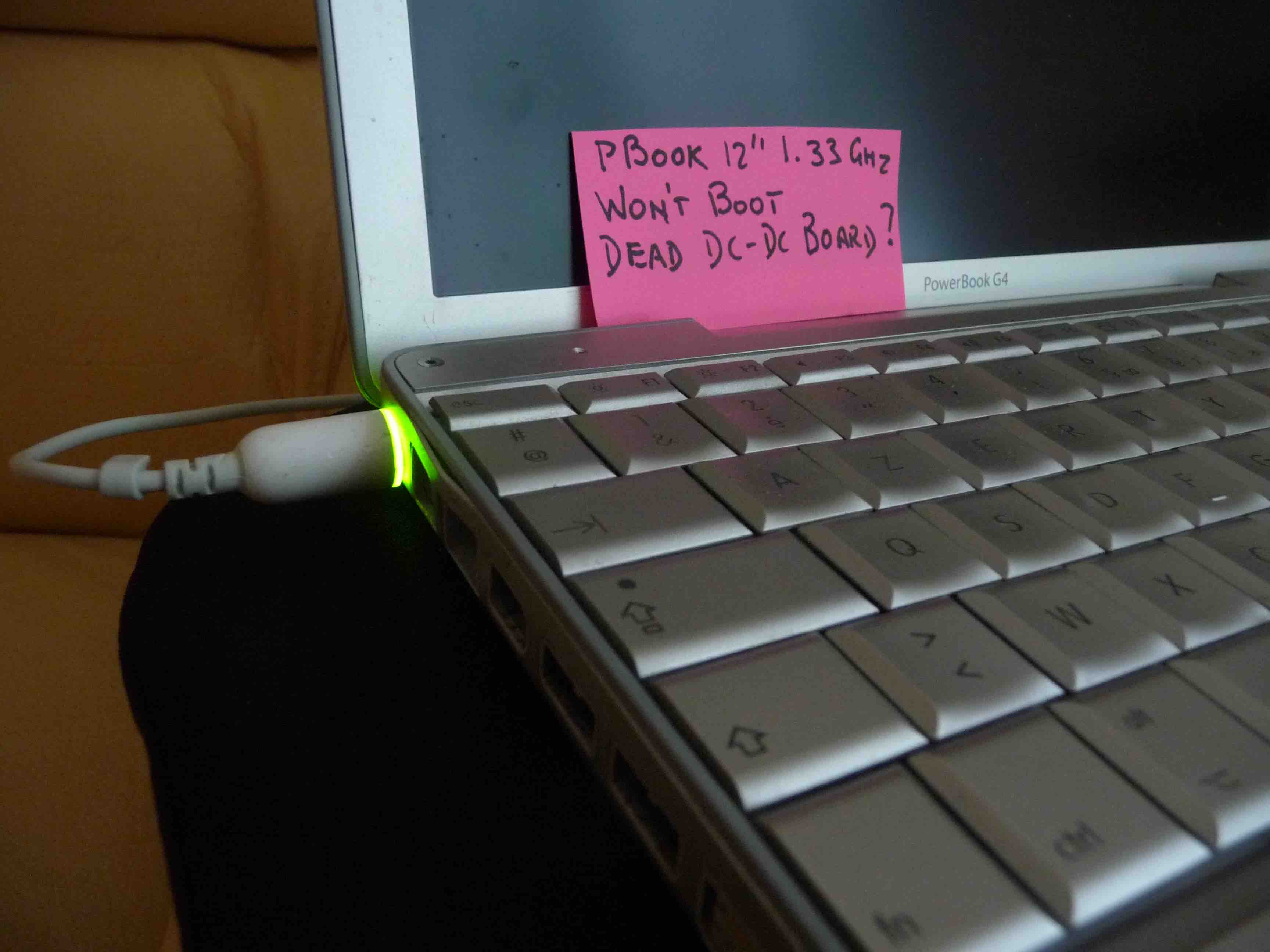

With ref to your comment, "PowerBook G4 12" 1.33Ghz - dead DC-DC board. Good battery."
An aesthetically good, complete PBook6,4 1.33GHz (A1010) I recently acquired for spares doesn't boot, as correctly described by the seller, who also added, "One day it wouldn't power on, and charger light when connected remains green even with battery removed". Photos follow:
I've tried the several common known attempts - PRAM reset etc, and also another good known battery and another charger. Charger light still remains green when connected. Would this point to a suspect dead DC-DC board?
As we who have tinkered with these 12" PBbooks know only too well, a change of DC-DC board is akin to a surgical removal of an appendix wearing a blindfold - in terms of difficulty. 🙁

C’mon, it’s not that bad. it’s just the key cap removal that instills fear in me. The rest of it is just screws and plugs.
I was lucky with my 1.33 to visually see a blow out on the DC-DC board, combined with a brown burn stain on the underside of the trackpad.
However... it was still capable of charging the battery (amber light). But that’s not to say that a different blown component would prevent the charger from switching from green to amber
When it comes to a non-boot scenario, the only real option is to dissect. It could be either the DC-DC board, the DC-in connection (or wiring) or the logic board.
If you have a similar unit (1.0 - 1.5ghz) then you can try using a known working DC-DC board pulled from one of your other machines before removing the heatsink, logic board and DC-in connector and wiring.
It only takes 10 minutes or so to dismantle to the point of removing the keyboard and top case. Just take your time with the F-keys 🙂

C’mon, it’s worse than bad.....😉
Seriously though, it's exactly the removal of the 4 key caps, those micro connectors with their extremely flimsy flip-up retaining bar, and the spaghetti junction cable runs that instill fear in me. Think I'll take a sedative later tonight in preparation for another 'High-Noon' PBook 12" encounter tomorrow.
