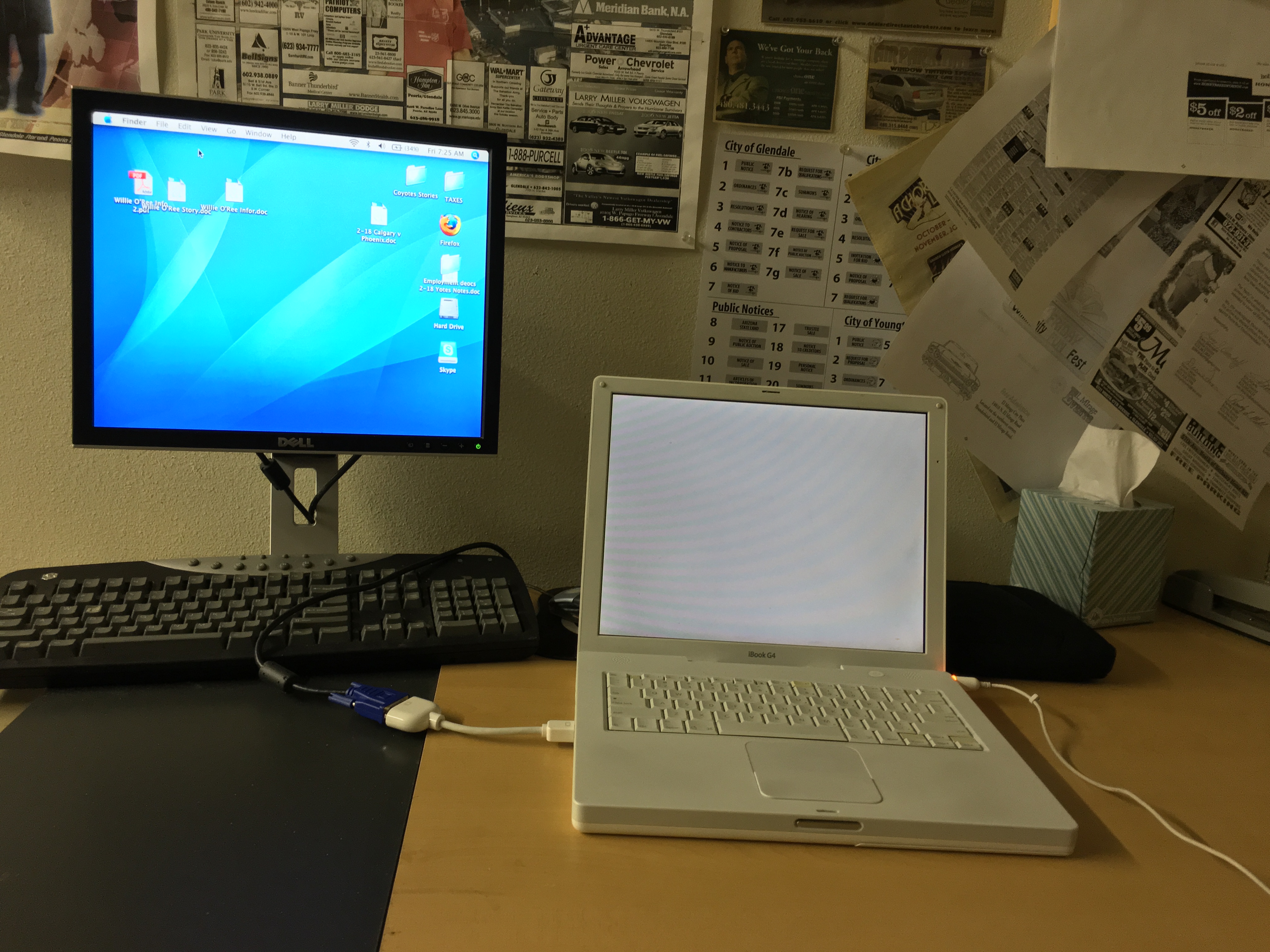

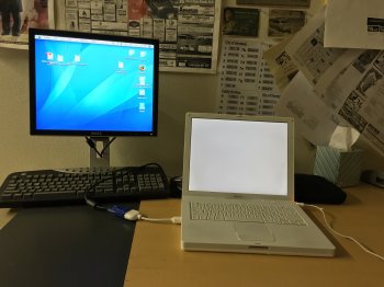

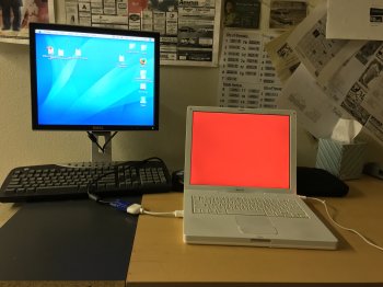

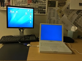

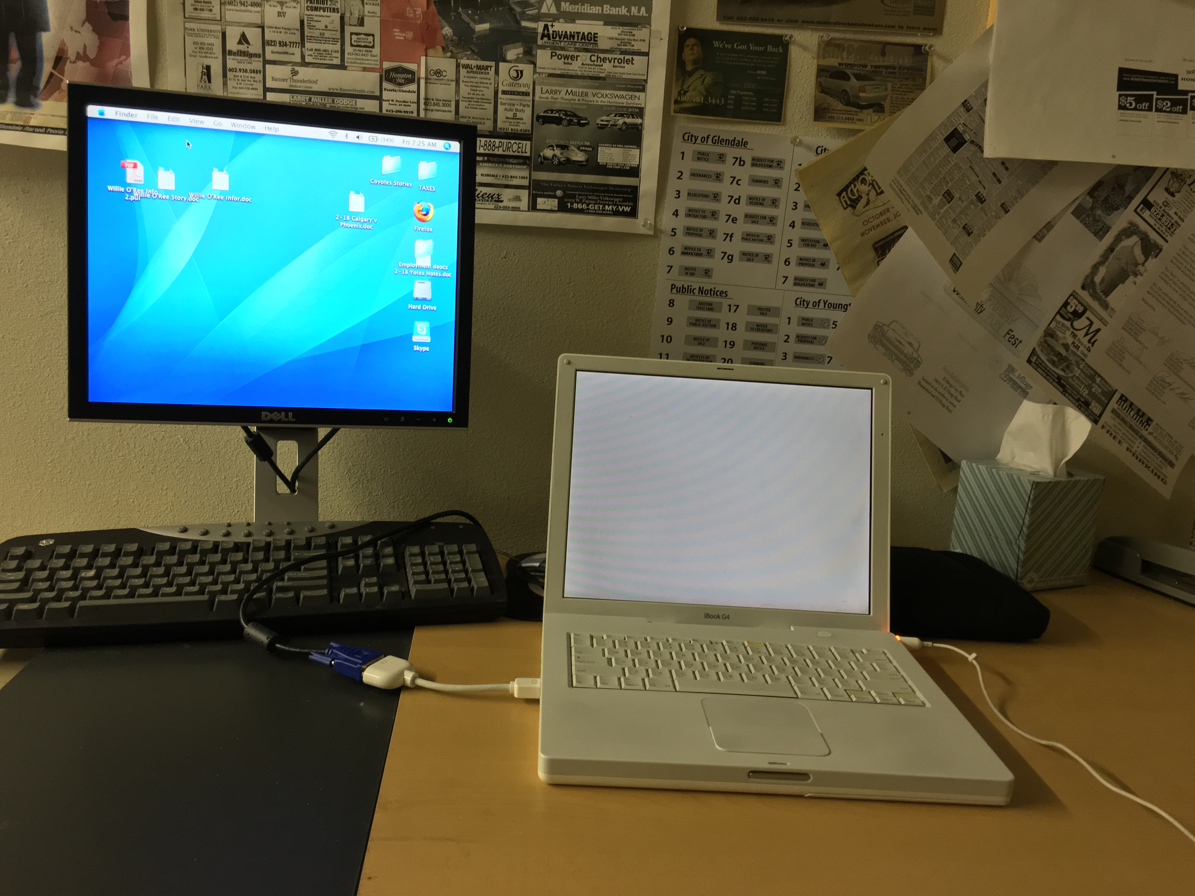

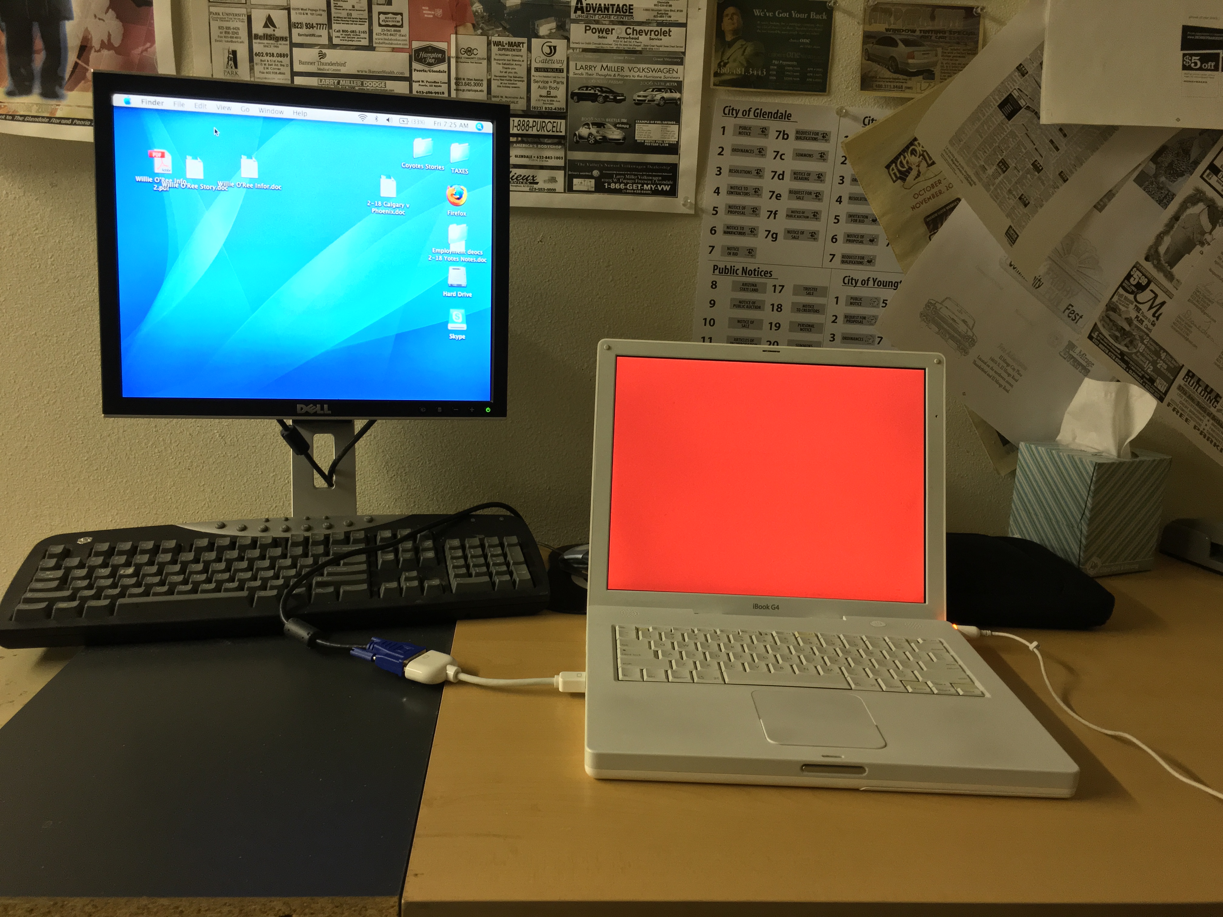

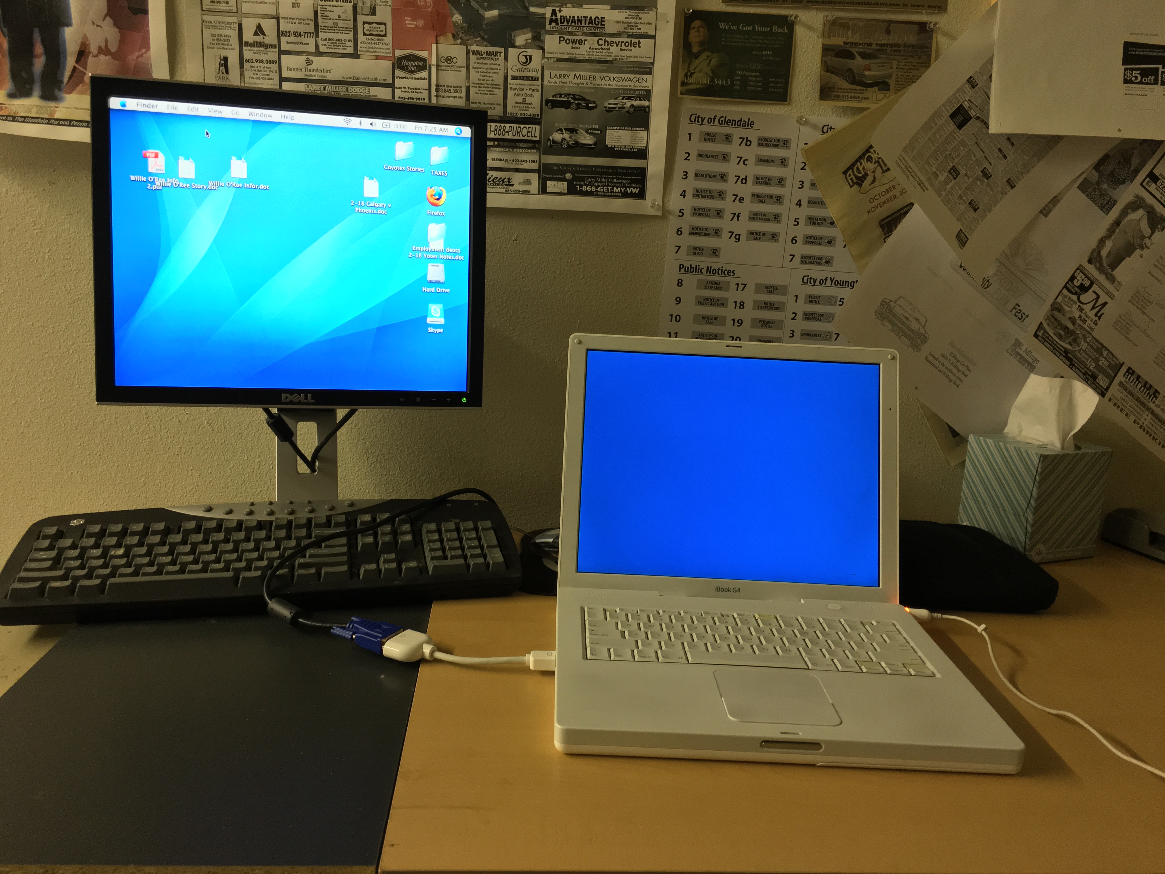

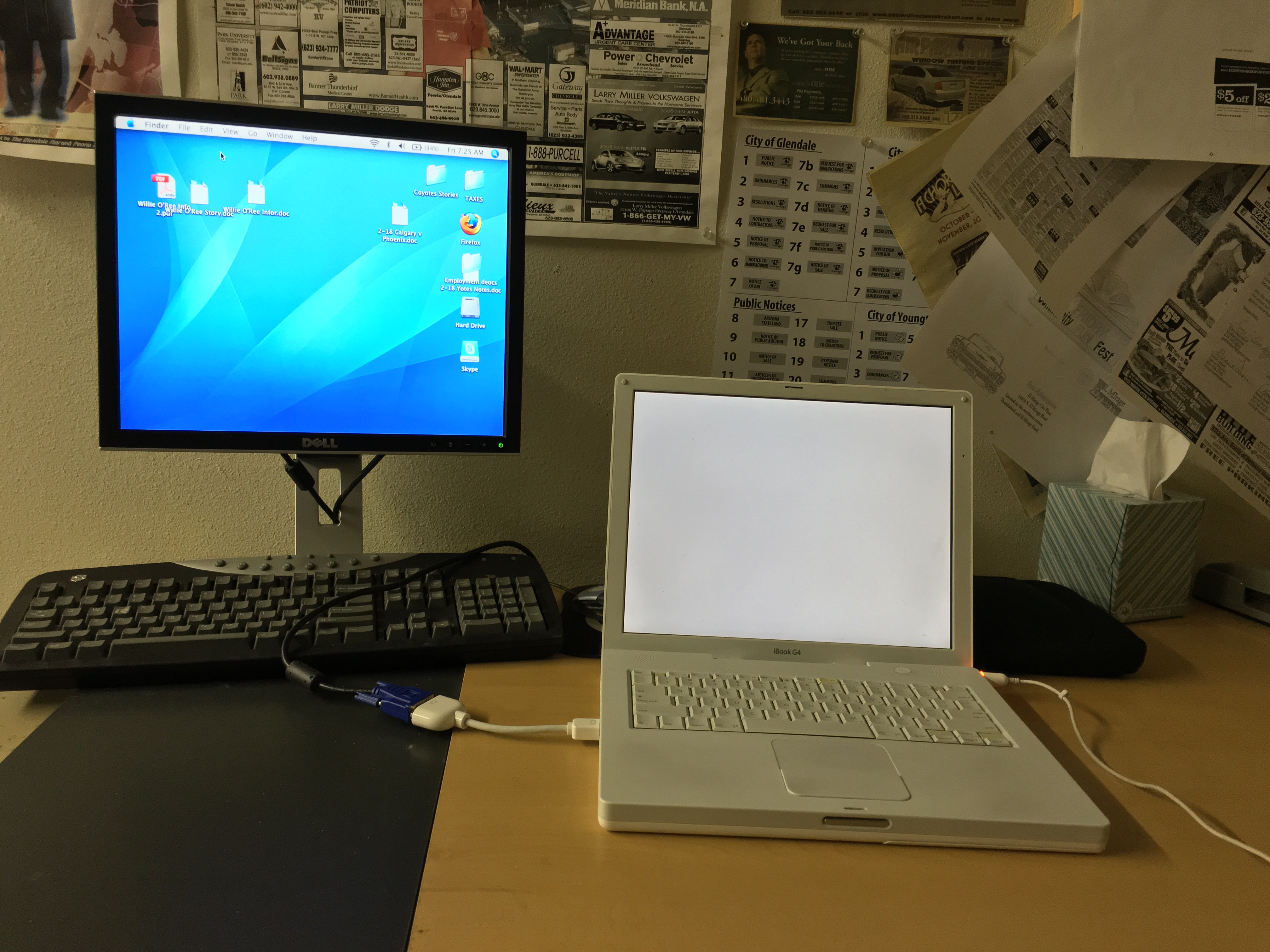

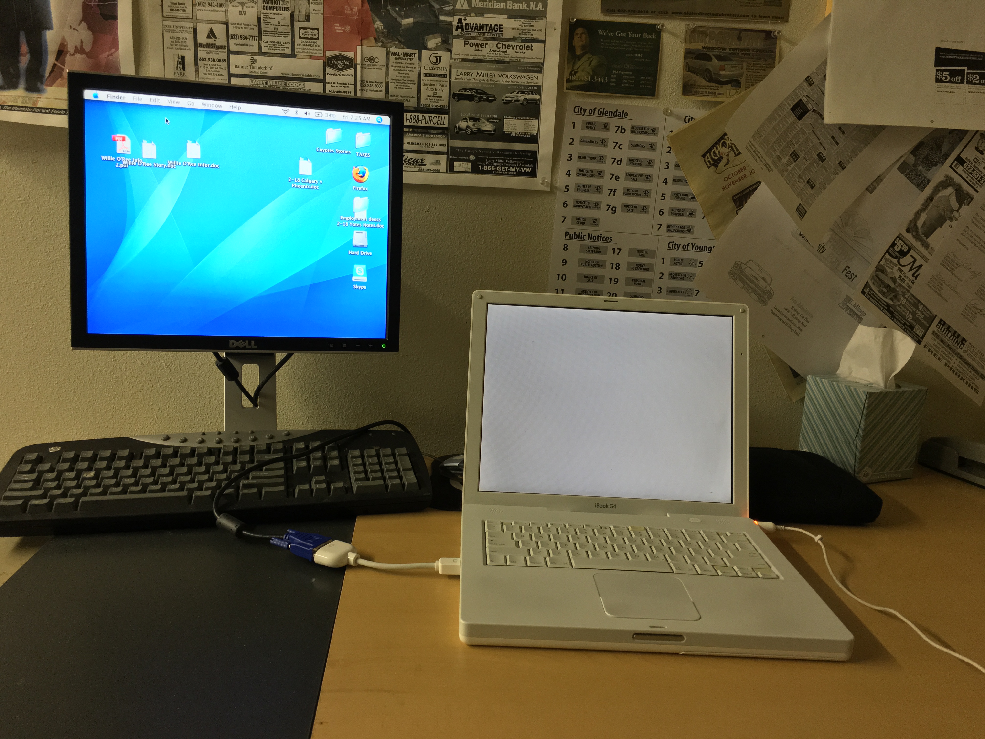

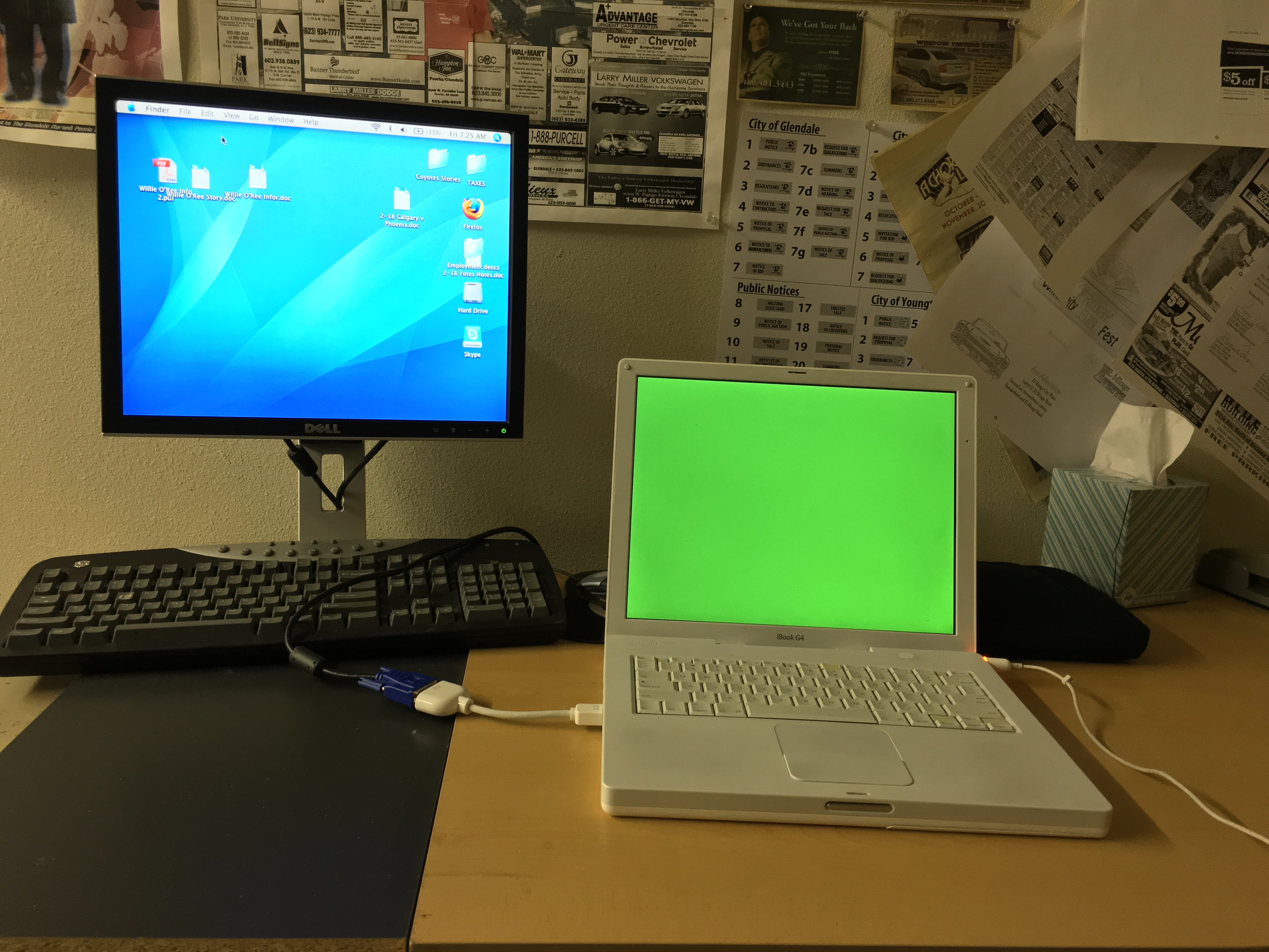

Got the adapter last night and brought it in this morning.
Works perfect and the following pics prove that the logicboard is fine. Just trying to determine if the issue is the LVCD cable or the display itself. Color is solid, no lines and proof that the backlight works. My guess would be the display because if the LVCD cable was bad I should be seeing glitches right? It's cycling through these colors.

interesting Failure mode it almost looks like someone was running ASD on it (one of the tests in it is cycling through those colours) but evidently it is not... if i was a betting man id bet on the LVDS cable IMHO. luckily parts for these are quite cheap and you might be able to just pick up a complete LCD top case assembly LCD and LVDS cable included. I see its the top spec 1.42Ghz iBook G4 those are nice machines. if your coworker is not interested in fixing it and just gives the machine to you and your not looking to repair it you could just remove the LCD top case completely and create what some people call half tops and use it as a small desktop or sever or something 🙂

Yeah, I was thinking cable originally but then thought it might be the display because it's cycling like that, but I wanted to get a second opinion. I believe I may have a spare 12" screen in the black hole that is my garage. Going to have to take a look this weekend.
