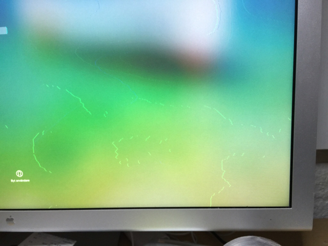

Hi all. Just got a used 680 to replace a 6870. Its flashed now but i have a problem with green dots/artefacts on the 30" ACD. The problem was there before flash also. It persists in windows as well. On both dual link dvi's. But only on the 30" my two 20" are fine regardless of port. ImageUploadedByTapatalk1431263761.897670.jpg
To me, it looks like you have screen burn-in if its only appearing on the 30". It looks like it has a very distinct shape to it.
I think there are a few programs around the web that can try and fix it, but won't guarantee to get rid of it.
If it doesn't do that when you go back to your old GPU, then you might have a faulty dual-DVI port on the card.

Its not burn in as it moves around with graphics or windows.
It appears in between colour gradients almost looks like 8bit colour or something
Ok solved attacking cable connecting to card resulted in a varying screen changes one of which was good. So its a connector problem
Time to clean connector, but how?
Arrgh! The bloody thing can be made to go away with manipulation of the connector bit comes back after a sleep or restart! WTF!!
