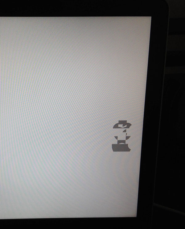

I have an early 2011 Macbook Pro 15" and for a month I've seen this screen artifact right before I get the login screen (see photo attached).
When it started I was using Lion 10.7.3, so I decided to upgrade to Maverics. I did a clean install, but the problem remains. Has anyone experienced something similar?
Thank you.

Garbled Apple logo. Unless it gradually gets worse, I wouldn't worry too much about it. Probably will get worse, though, since it is over 3 years old after all, and only recently started happening.

For 2011 MBPs this has been a sign that the GPU is starting to fail. I'd keep an eye on it, and see if the issue increases in severity.
