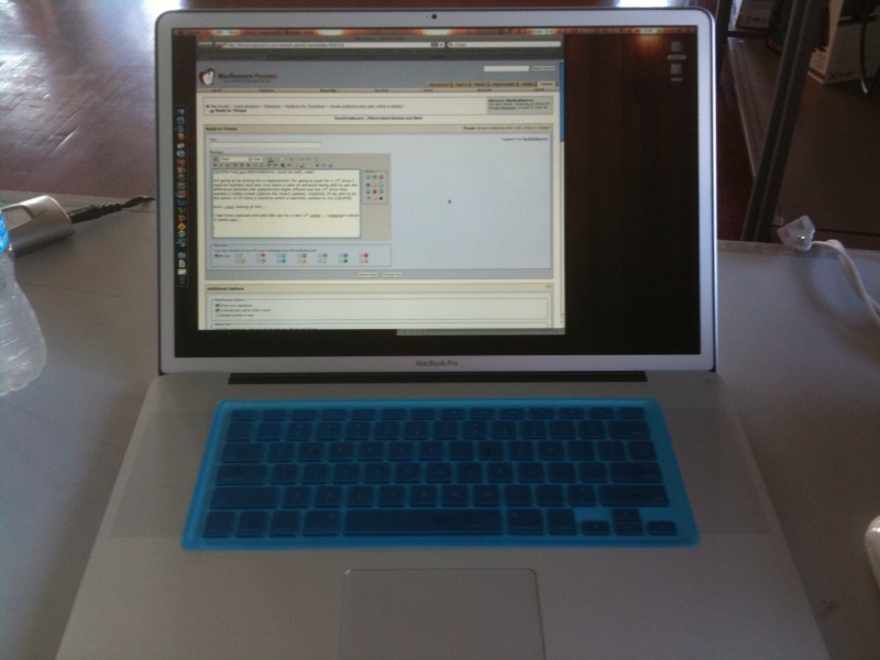

sure...your looking at him....
i had 15" replaced and paid 300 cad for a new 17" umbp....i recieved it about 2 weeks ago....apple bumped me up to the 2599 model and let me choose if i wanted to pay more for a even bigger 17"
here he is....crappy pic....bad lighting...lol
HA, fantastic! Glad you're enjoying your new machine, hopefully I'll be in the same boat soon...
