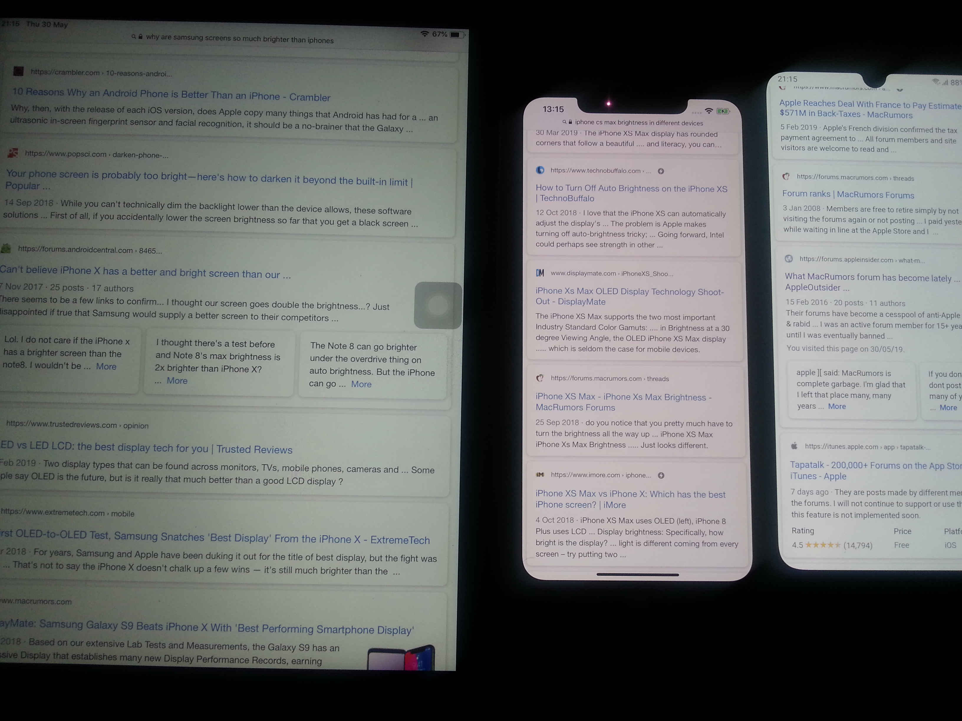

I knew my XS Max was leaning on the warmer side & assumed they were all equally warm but went to apple store to have a look anyway. The guy i spoke with said it looked fine and just something apple had implemented into new Oled displays.
I was on my break and didn’t have much time to compare all store devices but the couple that I did quickly glance over definitely seemed to be far brighter than mine at max brightness. Whites also looked like white, on my device whites have a yellowish, Murky tone. White almost looks dirty..Anyway i left the store dissatisfied and last night I compared my max along side my iPad and a galaxy A70 and was really apparent how grubby the max display looked.
I’m sure this question has been asked countless times before & you guys are done explaining BUT..Does my display seem off or is this normal for these oled iPhones? I personally find looking at the display unappealing. What do you guys think?
Edit:
True Tone is Off. Night shift is Off.
Auto Brightness disabled and white point disabled.
All 3 devices are set at 50% brightness
Xs max is centre.
It's messed up &  won't fess up to the fact. It should look white. Maybe warmish white, but not have a noticeable tint to it.

I probably would have gone along thinking the XS max was a super powerful device but with a sub par display and thought that was just the way of things. It was only when I compared it side by side with other iPhones and then my iPad & the galaxy device that it became apparent how abnormally skewed it looked.

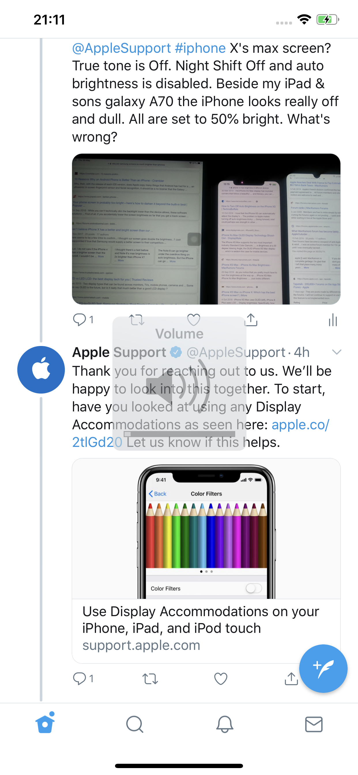

Incidentally, I did reach out to apple support on twitter and showed them the image and they recommend I turn on the colour filter option. I can’t get it to anything remotely white or even acceptable white-ish. I’ll keep messing with it but any tips on using this feature would be appreciated if anyone uses it?

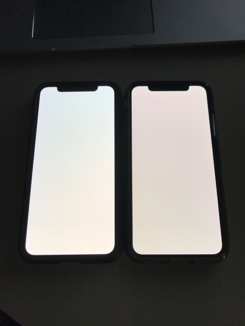

I have had similar issue last year when I bought a second IPhone X. Side by side comparison showed a clear difference.
Apple Premium Reseller replaced it.

Curious, So from my image above do you think the A70 Samsung (on the right) Looks worse than my max? It’s interesting because the first thing I commented when my son showed me the Samsung was how impressive the display looked. I’m assuming my Xs max is just a lemon because I’ve seen others who don’t have these issues.

I can see it. The x on the right has IMO the less desirable tone although it still looks decent. It looks more creamy coloured white as opposed to yellow. Mine looks pink or red-ish from the image I posted but in person it shows more a yellow shift throughout.
[doublepost=1559481568][/doublepost]Something I have noticed that makes me think my display has the ability to be what is considered normal. While messing with True Tone I have discovered that if I pull down control centre and switch both TT and Night shift on for around 30 seconds then switch both off my screen goes to looking almost perfect. Whites are no longer yellow as it appears to favour a cool tone “initially” but then gradually changes the shift back to yellow.
It looks great for around 5 minutes and then for whatever reason the calibration of my particular max’s comfort zone rests in the overly warm.
I’m now wondering if my ambient sensors or the TT sensor in particular has an issue. It seems to be working somewhat even when disabled. Like a background monitoring of my phone’s colour temperature. I want to let it know that I don’t like what it thinks is right. Other than disabling TT & NS is there anything I can do to keep the initial cool tone that results from cycling TT/NS on/off?

Anyway side by side with another iPhone it should tend toward the same white with truetone. If not it should be replaced.
