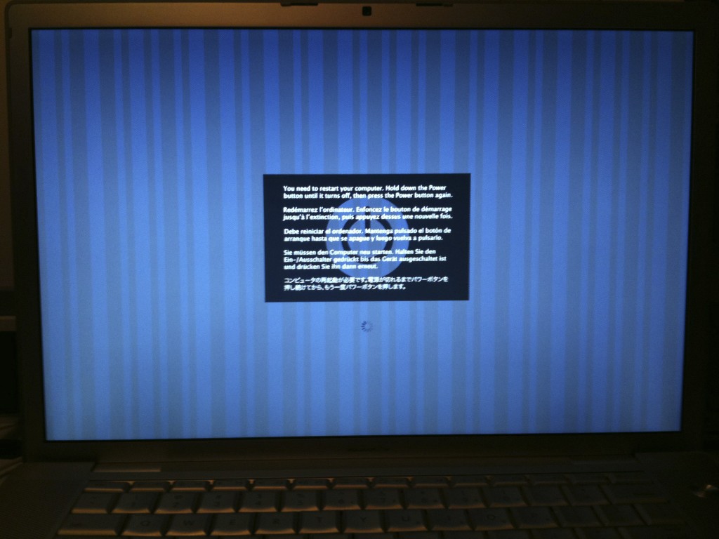

Jips quite looks as if your graphics card went to hell...
All of a sudden the MBP will not fully run anymore!
I power on, it start to load, then the Reset image as the one posted above appear!
So I tried to let it start from USB but it does not! (I have an HDD with a fully working Tiger OS I used for testing purpose)
When I start the MBP pressing and holding the ALT key it won't recognize the USB drive but only CD and internal HDD partitions.
So believing the internal HDD could compromise the machine I pulled out the HDD, I left the MBP without the HDD and I tried to load it from Snow Leopard DVD but it hanged with the same reset image showed above.
Then.... 😡 i formatted and cleared an old HDD and I pulled in to install the OS but... since the loading from DVD will not work.. this will not work
So I really guess it is something hardware related.
And I guess I can't fix it easily unless I change Motherboard! Isn't it?!
I'm really sad!!
The worst thing is that if I'm going to buy a new MBP it is not worth since the new MBP series with I5 processor should pop out in a while!!

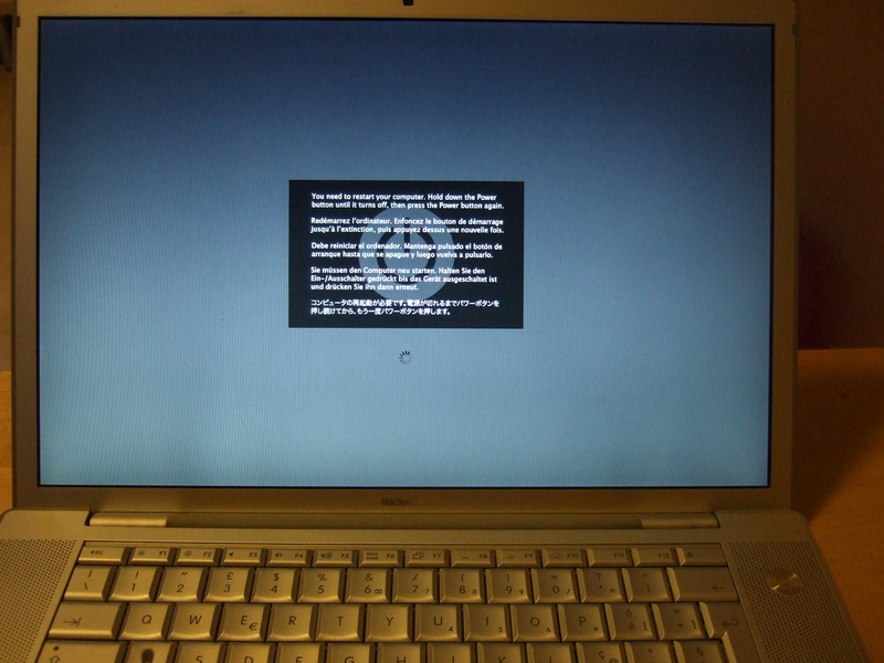

I've got the same problem!!!! I have 2.4 Santa Rosa! That's is very strange!!!! Damn :apple:!!!! I will have to buy a new MBP soon!🙂
I have the same problem on mine as well. But I used the SL DVD and Disk utility and seems like it works...Idk for how long tho 🙂
Yes it worked for me the first two times... then... the system can't start at all with any DVD (Original Leropard DVD and Original Snow Leopard DVD!!)
I'll bring to the apple center to see if they can do something about that..
Few days ago.. I just bought new 4Gb memory to bring it to 5 AND a new battery!!!! Damn! I wasted 300 Dollars more or less!!
Had the same problem several times. I just did a reformat each time and it fixed it. I'm not techy so wasn't prepared to try and find out what the issue was at the time.

My Santa Rosa 2007 MBP just started failing very similarly, but just the lower 3/4s of the screen. Barely usable, then it usually gets better after 5-15 minutes. Holding out hopes of Arrandale bump -- I'll get a new one before I send this one off to warranty so I'm not computerless for a week or more.
You better go immediately to a service center to get it repaired since it won't last long I guess if it is like mine!

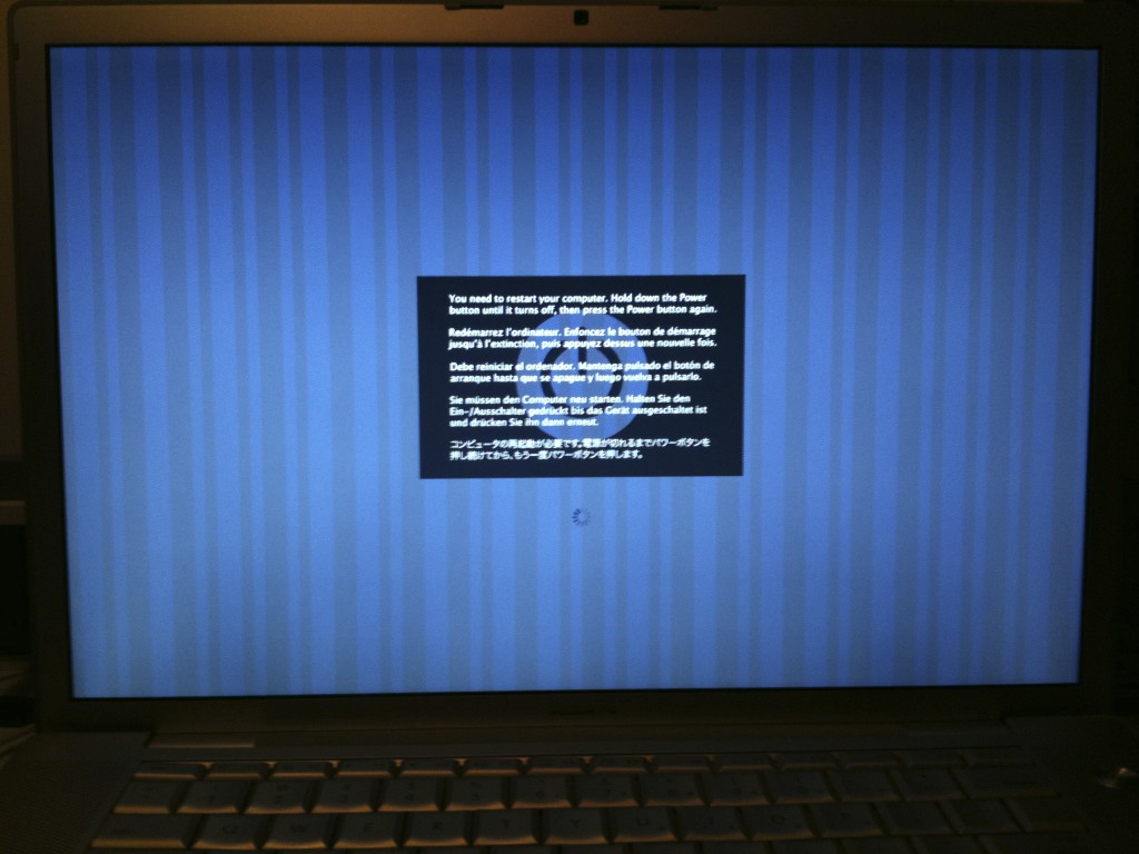

I have the exact same thing, and it has to do with the nVidia 8600GT in the computer. I have the exact same model as you, the 2.2GHz, and mine died a few days. But right now it is running fine. I ran Apple Hardware test and it came up with no problems. However, I kept getting these horrible screen flickers where I could not control anything (computer froze) but the mouse was still movable. Eventually the flicker turned into blue lines down the screen. Restarted my computer and got a kernel panic with blue lines down the screen. It's an on and off issue, but it is definitely the GPU. I have a box coming here on Monday.

Exact same thing here. I am using mine right now, but once the temp hits 140F my screen goes nuts and I cant get the computer running for hours. By box, if you have AppleCare and you call you can request them to do a mail in repair.
Right... it is related with old 2007 models I think with 8600 Nvidia card.😡
I've got the whole motherboard replaced for free!! 😉
