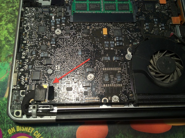

The diagnostic was correct!
It was the video data cable, but fortunately it was only a little bit loose.
I disconnected it and connected again, I got my video back.
Here goes a screenshot to anyone who come to the same problem.
Thanks for your tip. 🙂
