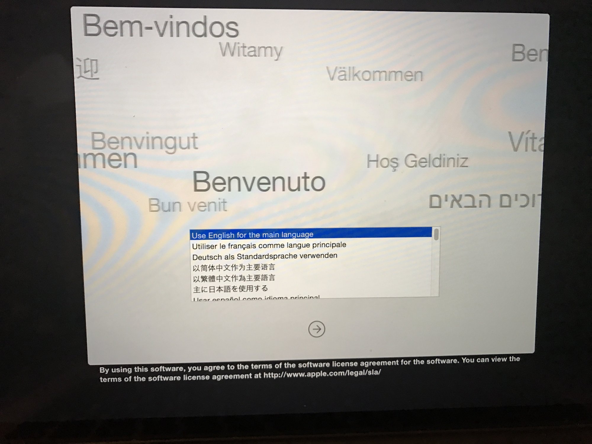

Tried resetting the PRAM in the past. After hitting the power button and holding down CMD+OPT+P+R to reset the PRAM, the screen comes on for an instant to reveal the Reset Menu (per attached image obtained online). I've found that if I unplug the machine for several hours, that it will boot up to the log-in window for 20 or 30 seconds. Upon logging in, the desktop displays before the screen goes black after 30 seconds or less.

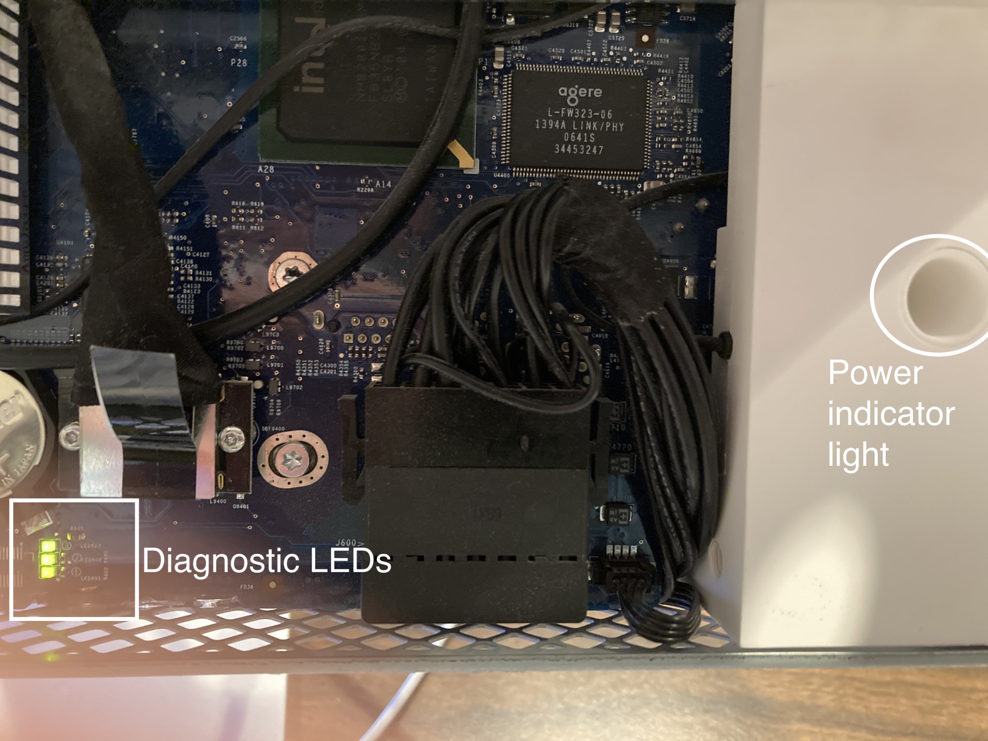

Found Service Manual for late 2006 iMac online. Symptom Charts indicated problem may be inverter, which I replaced. Screen still goes black after showing log-in window for a few seconds (not enough time to enter password) upon booting up.
Attached image shows the 3 Diagnostic LEDs are ON. The bottom LED indicates "the power supply has been detected by the main logic board." The middle LED "indicates that the main logic board has detected proper power from the power supply when the computer is turned on." The top LED "indicates that the computer and the LCD display are communicating. This LED will be ON when the computer is turned on and video signal is being generated." The front LED (power indicator light) comes on when the computer is booted up, but then goes off and stays off.
Wondering if this information helps anyone identify the cause of the screen quickly going black when booting up.

At this point, I'd follow the suggestion by @paardenkapper to test the iMac with a 2nd display and see what happens.
