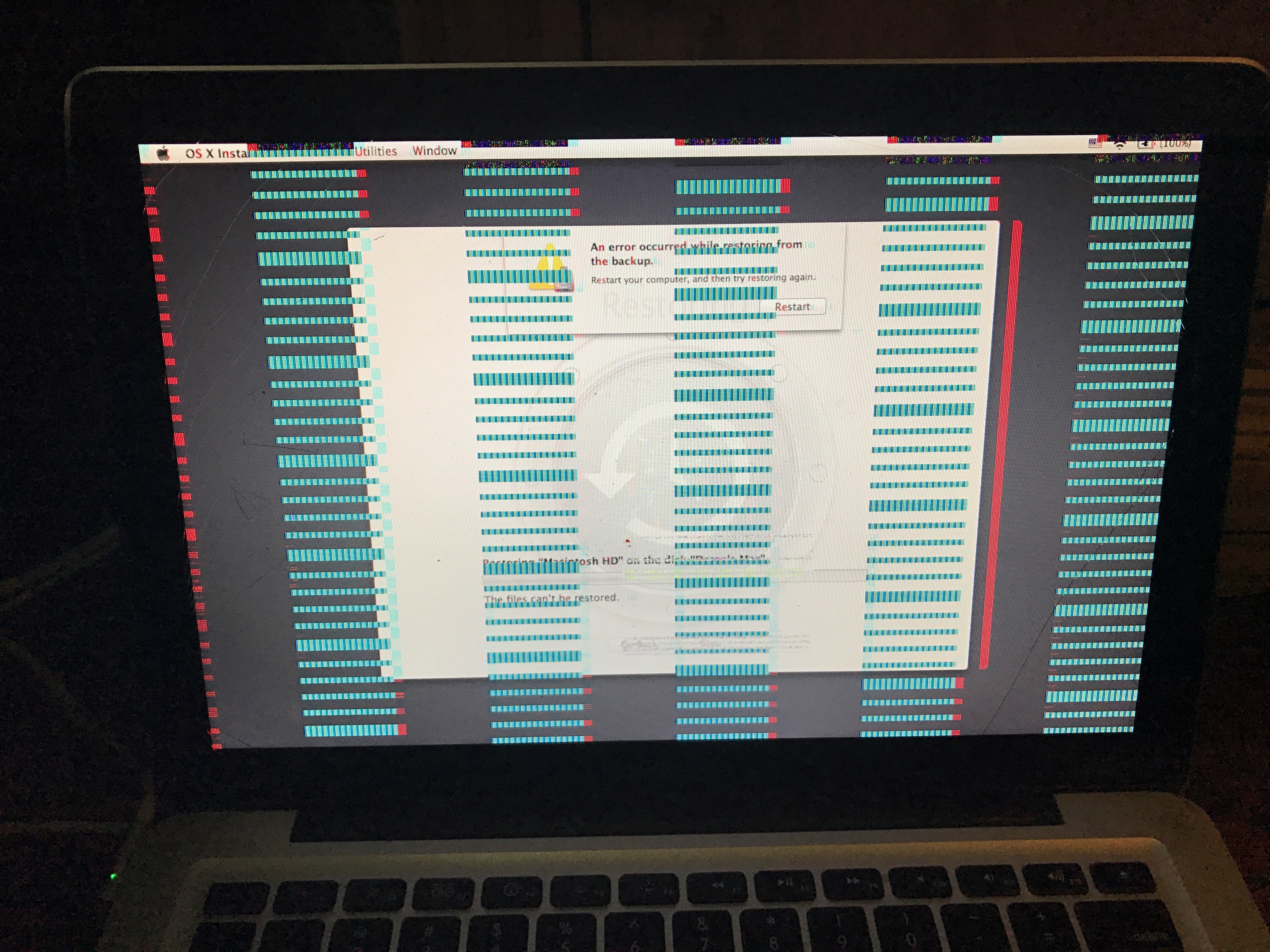

So I dropped my MacBook a few weeks ago and the hard drive was damaged. I upgraded my HD from 300 to 750gb and my ram from 4 GB to 16. Turned it on and everything worked fine for the install. It randomly gave me this screen once (see below) so I had to hard reset but after that worked fine. Now when I was moving all my stuff back over from time machine it happened again. A friend told me it could be video board and that its irreplaceable?
Normally that would be graphics as it looks identical to a dead GPU. However you have the 13" model and it's very unlikely for the iGPU to fail.
As you recently upgraded your RAM, I'd say that's causing the issue, especially because VRAM is shared with the RAM. What model/year MacBook do you have? The 2011 can only take 1333MHz and the 2012 takes 1600MHz.

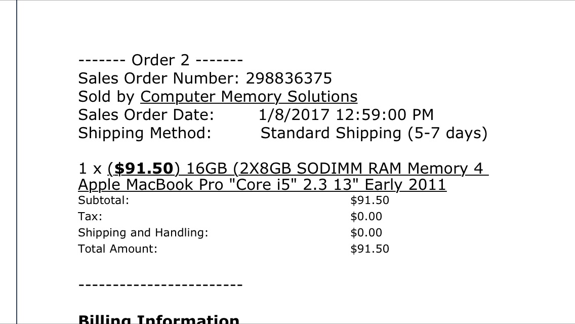

The model number is a1278 I believe it's a 2013 unibody. Picture enclosed is ram.
[doublepost=1485114635][/doublepost]Before buying the parts I read that my model can carry 16gb although the official Mac store says it can only hold 8gb.

Ah that's why, you have the Core2Duo model. They're very, very picky with 16GB RAM. You frequently can't go beyond 8GB RAM on them, if at all. Only the 2011s or later can reliably go beyond 8GB RAM.
Also the RAM you ordered is 1333MHz; it should be 1066MHz on your model (2x4GB SODIMM).
Anyway, best thing to do is replace the original RAM and reinstall OS X from there. Should work fine. Then return your RAM and order the 1066/2x4. 🙂
