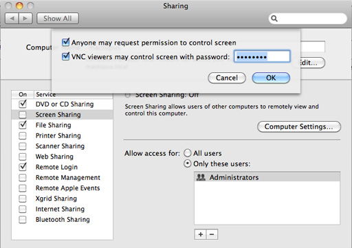

    You can't use your OSX creds with a normal VNC app since the standard VNC protocol has no concept of username. You have to set a VNC password in the system preferences on your Mac. Go to the sharing tab, enable screen sharing, click the "Computer Settings" button, and supply the password you want to use for VNC.
    [​IMG]
