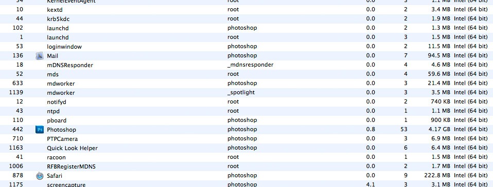

I don't have that running... Here's a screenshot of my Activity Monitor:
