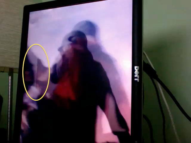

Edit: I just tried to record the effect with ScreenFlow, and the recording looks perfectly fine. I also tried watching video on the display, and there's a slight tearing there too.

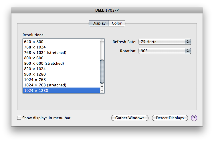

I changed the refresh rate from 60 Hz to 75 Hz (the only other option), and the tearing is no longer noticeable while scrolling, but it's definitely still there when playing HD video.

Update: This only seems to happen while the display is rotated in System Preferences. It looks the same when set to 90º, 180º, or 270º. There's no visible tearing when rotation is set to standard.

The effect for me isn't a colour, it's just that the right/top side of the screen is lagging very slightly behind the rest.
You see it on your external display? Is it rotated as well?

Will do. Here's a clip of the problem, although it isn't particularly clear because the framerate playing HD video and recording at the same time rather sucks. I've isolated and attached a frame where it's particularly visible, on the left side because Photo Booth flipped the video.
http://dl.dropbox.com/u/68829/tearing.mov
And no, I wouldn't normally play 16:9 video at 4:5; just wanted to fill the screen to better illustrate the problem.
