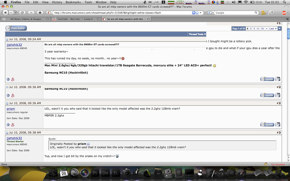

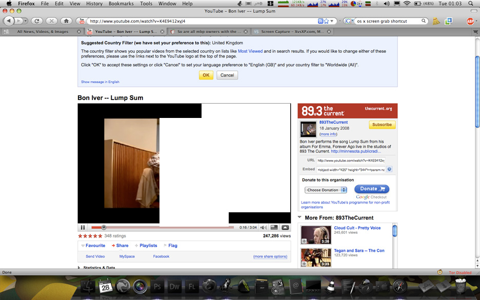

The last two days i've been experiencing some bizarre issue with my laptop.
Basically, all embedded Flash objects will flicker white boxes during playback, especially in video playback. This isn't an issue simply with youtube and affects all other flash video sites (myspace, google etc). It affects both Safari/FF and i've updated all browsers and plugins without resolution of the issue.
I'm also getting what I understand to be referred to as screen tearing. Certain documents/sites affect this worse and it seems to happen more when i scroll the screen. So basically, as the screen content is updated, the pages become fractured, randomly rendering image chunks over the top of each other.
I've had trouble grabbing screen shots of the issue as it flickers so fast, it's difficult to catch it when the tears and boxes occur but i've been successful in grabbing a few which you can see below.
