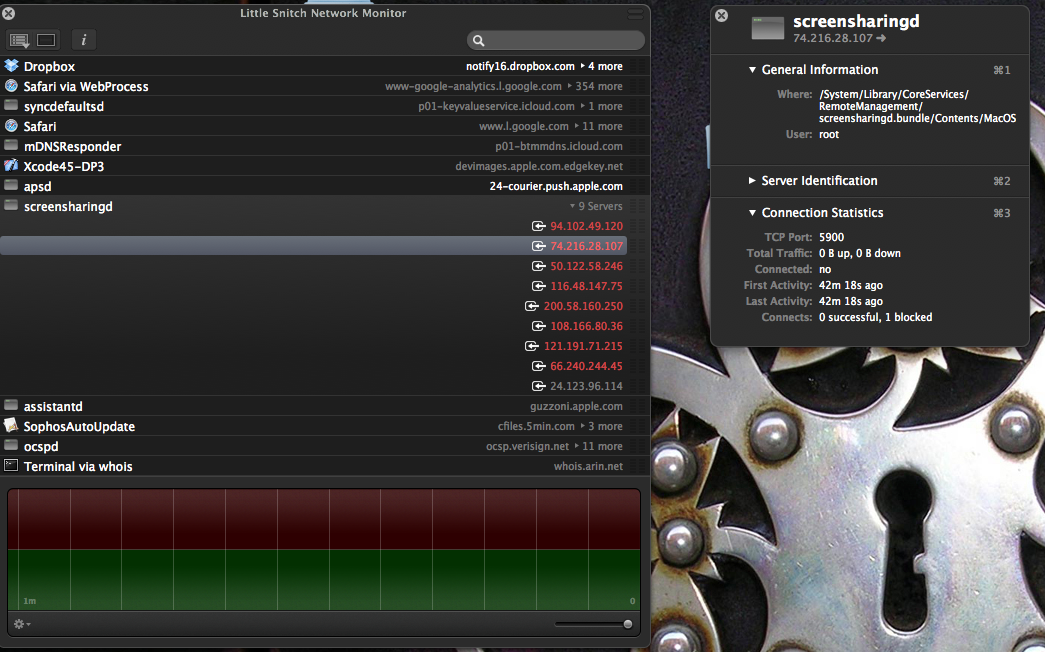

Good day guys.
I installed Little snitch today.
And noticed that the service "screensharingd" is trying to connect out so far 9 different ip's when I do whois on the ip's they don't look so legit...
Has anyone run into this?
Any thoughts?
I've enclosed an image with the IP's
Good day guys.
Any thoughts?
If you don't need screen sharing you can always disable it in Sharing under System Preferences.. better to be safe than sorry.
I use the service a lot it's my office computer so that's not an option
And FYI I use remote management with ARD not screen sharing it self
This had me stump I'm just worried abit if it's mailware trying to call out on screensharings default port 5900
But don't know how it would infect a core service with root permissions if it is

I do have a hardware firewall installed and its setup only to allow specific Mac address through that port.
That being said we are not talking about connections in.
Little snitch only show out going connections.
You can use the terminal command
lsof -i
That will show you all listening or established connections
Now there are no incoming connections on that port.
Just the occasional outgoing from that service when it's running

Hey guys.
Yes I have a dedicated box running Untangle.
And I am a Director of IT by trade so it's set up correctly
I really do see this as being some kind of Trojan somewhere at this point.
I can not reproduce this on any other computer on the same network
My latest IP that it is trying to connect to is 216.164.203.22

Stan,
Heres the thing.
I don't see this as someone trying to connect from outside.
I see this as something on my machine trying to connect to a server using port 5900. Which if you ask my is prob why it would be connected to something with a vnc.
That being said I see no logs of those IP's on my router coming in on any port from the outside.

screensharingd is a service, ie it can't normally initiate a connection. There are some exceptions, such as an echoserver, but it would require a total rewrite of the binaries involved. Thus in order to do this, they would have to have complete root access since you've upgraded to ML, since looking at my files all have been modified since upgrading to ML. I'm not saying it's impossible since they could of had root access before the upgrade, but it would take either a dedicated person, or an inside job to rewrite the binaries to accomplish the task.
Other option would be to use a socks proxy or vpn to gain access to the network and bypass the ACLs on the router, this would show up on the logs though as coming from that IP address that is compromised and not the external address.
Either case, the best option is to say, take all relevant log files for forensics and a legal team, and start with a fresh slate. Most likely it will also involve changing all password on the AD or LDAP as well.

@h1kar1: I have the exact same issue after installing the newest Little Snitch. I also recently upgraded to Mountain Lion. I am not sure what has changed. I too get little snitch pop-ups saying that screensharingd.bundle wants to accept incoming connections from (insert random IP#)...on port ####. Shortly thereafter little snitch puts "terminated" over the pop-up and it goes away.
Note that it is saying that screensharing is being "poked" to allow incoming, not outgoing. I don't recall this sort of behavior in Little Snitch before. I thought it only looked at outgoing stuff... Or, is it something different in Mountain Lion?
I have port #### open on my router so that I can access my mac using VNC. Perhaps I should rethink that?
It seems to me that this is just people or bots sniffing around. It's probably always been happening. Something recently has changed so that Little Snitch is alerting when these happen now. Just to be sure I ran a virus scan and ddin't find anything.
For now, I've just been forever denying them when i see them...
Let me know if anyone has ideas...😕
For what its worth, Little Snitch 3 does filter incoming connections, and these are precisely what you are seeing with screensharingd: A series of incoming connections which have been denied. The small icon next to the IP address indicates that the connections where incoming, not outgoing.
Little Snitch - screensharingd

I am experiencing the same. Started getting these alerts after upgrading to Mountain Lion and a new version of Little Snitch.
I also have screen sharing enabled and a port open on my router for VNC.
The IP's I'm getting are:
222.66.209.181
113.118.97.114
220.178.30.232
I'm also getting requests from IMRemoteURLConnectionAgent
23.73.180.121
23.73.180.169
Any advice on a course of action for those of us with limited knowledge of IT?
DenyHosts seems to be the best solution I can find right now.
[Edit: It looks like Little Snitch 3.0 can filter incoming connections now. I am still on 2.3.6 which cannot do it.]
The problem is that Apple's flimsy "Firewall" only allows connections on a per-app basis. There doesn't seem to be any option to filter by IP address in a particular app.
