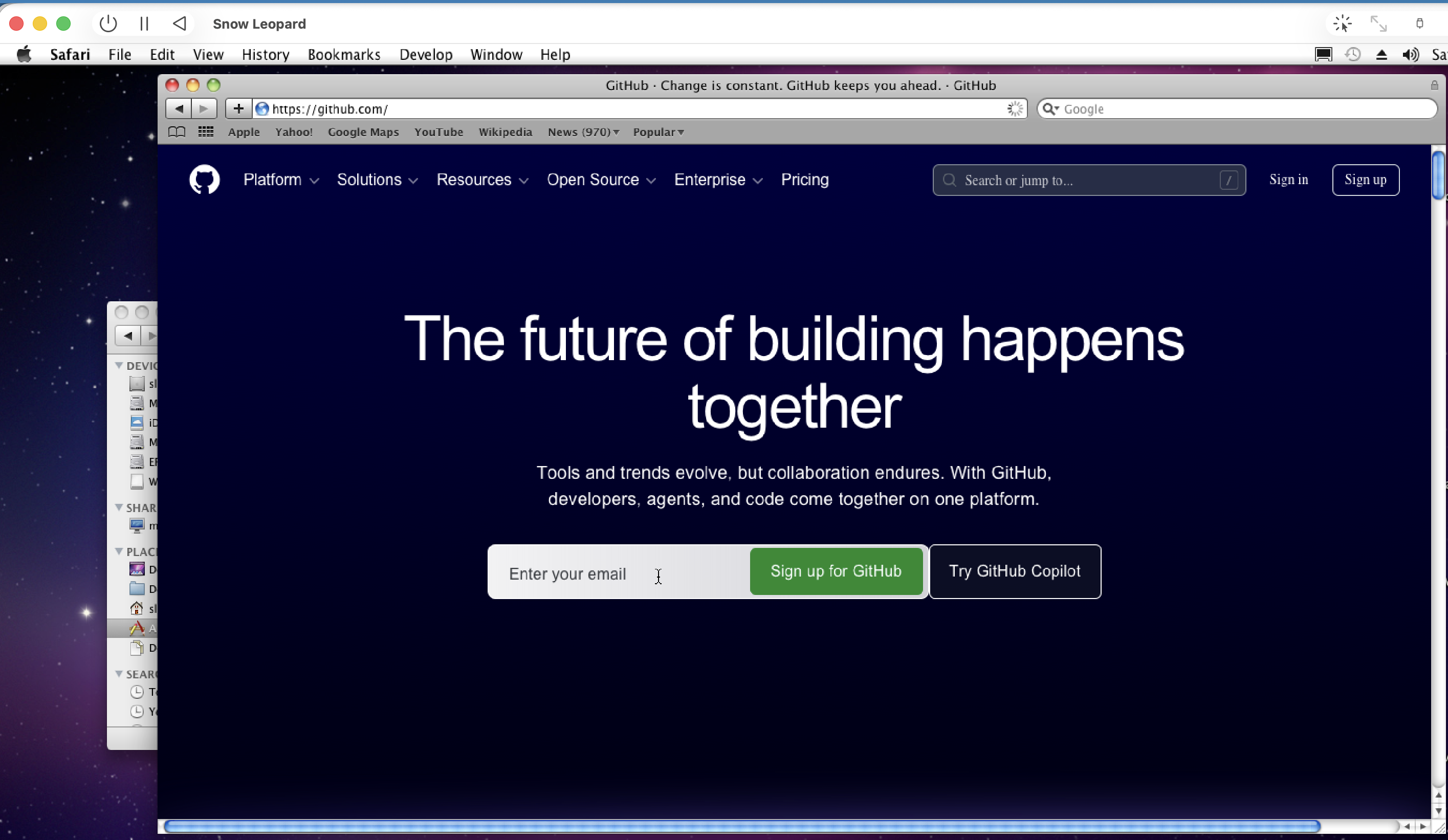

Just to be clear: There's nothing here you'd actually want to use just yet, I'm just showing off!
Basically, I set up Claude Code in a Mavericks Virtual Machine, handed it a modern compiler and the latest WebKit source code, and told it to backport WebKit to Safari 9 on Mavericks. Then I left it running for around 1½ months. A few times each day, I yell at it to either (1) stop being lazy and actually backport WebKit, not work on some easier task instead, and (2) avoid using hacks and remove any hacks it added previously. Occasionally, I also provide actual architectural guidance, such as telling Claude to use TCA instead of RLT for rendering, but this is rare.
It's definitely still a work in progress right now, but it does actually work. I can use Github, log into the New York Times, and play Connections, all from Apple's native Safari 9. It's not, like, a pleasant experience yet—pages take upwards of five seconds to load, and Safari will randomly decide to stop opening websites sometimes and need to be quit and re-opened. But if you were trapped on a desert island and this was your only way to browse the internet, you'd be fine. And, it has gotten much better in just the past few days!

The back story is that originally, if you scrolled or highlighted text or an on-page animation played, the picture would update at maybe one frame every five seconds. It was awful. I felt that fixing this, if it could be fixed, was going to require an architectural change, not little optimizations around the edges.
So I talked with a separate instance of Claude about what might be possible.
Claude said that it was currently using "RLT", or RemoteLayerTree, a rendering system originally built for iOS which is now also used by modern Safari on Mac. There was an older code path, "TCA" or TiledCoreAnimation, which was used by Safari 9 and was still present in modern WebKit. I, of course, told Claude to use this code path. Claude... very much did not want to do this, it kept hitting a crash, giving up, and going back to RLT. When Claude FINALLY did what I'd asked (well, the separate instance reviewing Claude's work said it had done as asked), performance improved enormously.

Ah the full explanation makes sense. I haven't looked at webkit source once, but I"m guessing TiledCoreAnimatino is similar to how firefox's compositor works (partition the screen into IOSurfaces and only update the ones that are changed) whereas RemoteLayerTree is probably actually creating a stacked layer graph and doing cross-process rendering. (I recall 10.9 switched how CALayer rendering works to involve WindowServer more heavily, maybe that all interacts poorly with remote calayers which were never stable in the first place)

The current status is that pages now load in a reasonable amount of time. Mouse cursor changes work (for example, when you hover over a link), videos work, QuickLook previews work, WebGL sometimes works, and I think memory usage is under control.
Any content that loads in after the initial page load (e.g. lazy loaded images) still takes much longer than it should. Overall app responsiveness isn't great (altough it isn't terrible either). And there's a variety of small things to fix, like making Reader Mode work.
The biggest issue is stablity, Safari frequently just stops loading pages and the app needs to be restarted. I'm nervous Claude won't be able to fix this, because it's not a cleanly reproducable problem it can keep pounding on until it works.
