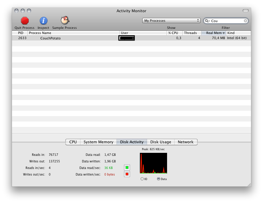

CouchPotato is available as a native OSX application.
