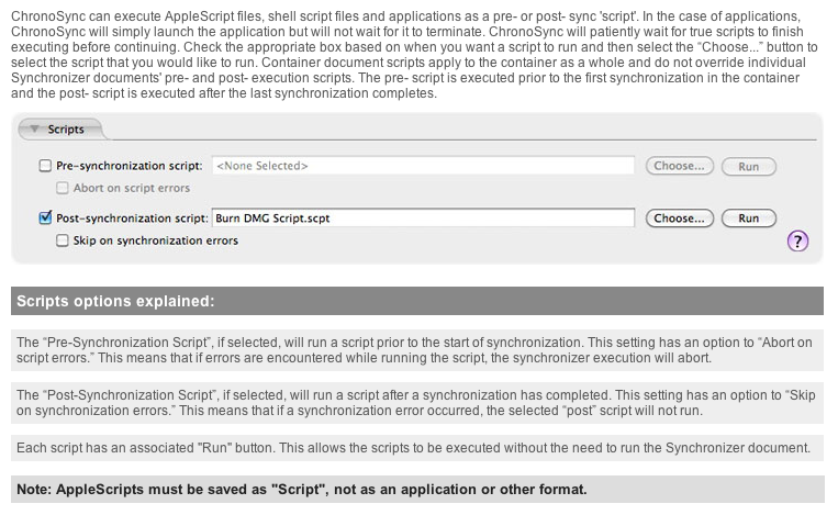

I am trying to use Chronosync to sync my iTunes library on one machine to my iTunes library on another machine, and Chronosync has an option to run a script before and after the synchronization occurs, which in my case would be great to run a script that quits the iTunes application prior to syncing it, then re-opens iTunes after syncing has completed.
Can someone please help create two applescripts... one to quit iTunes, and the second to start iTunes.
Thanks!
For reference, here is the ChronoSync pre/post synchronization script interface:

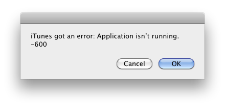

the script you suggested worked perfectly to quit iTunes on both machines, but when I tried it in reverse to re-open itunes on both machines (the post-synchronization script) it failed to launch itunes on the remote machine and it gave me the following error message:
Doug from Doug's iTunes scripts does say that following at the beginning of the page you referenced:
"The iTunes application on the remote machine must already be activated in order for an AppleScript on the local machine to control it. I couldn't get it to activate via a remote script."
It would be great if someone could help me figure this one out because at this point I'm so close to pulling off the impossible that it'd be tragic to fail now 😕
Thanks for your help! Look forward to seeing if anyone can help figure this one out.

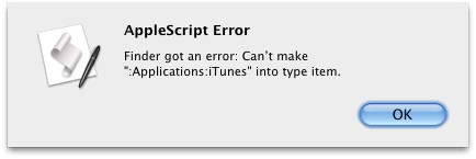

Try this to launch iTunes on the remote machine (found in 2 seconds using Google)
Code:
 tell application "Finder" of machine "eppc://username:password@powermac.local" to open ":Applications:iTunes"
I tried this and it gives me the following error:
Maybe try
Code:
tell application "Finder" of machine "eppc://username:password@powermac.local" to open POSIX file "/Applications/iTunes.app"
that worked! You pulled off the impossible! The cycle is complete. Now ChronoSync can quit iTunes on both machines, mirror the library from the Mac Pro to the iMac, then relaunch the libraries on both machines once the process is complete. PERFECT!
