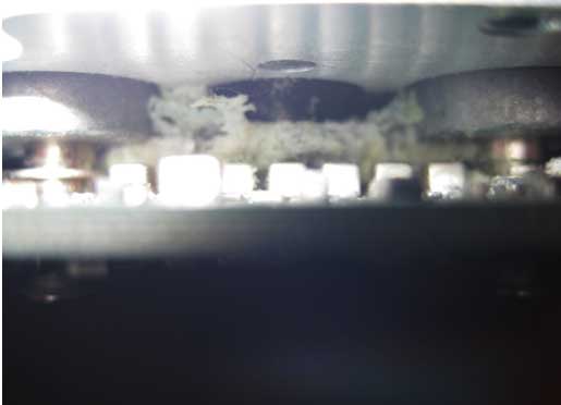

open the PowerMac and look for leaks as quickly as possible , dont just look for the green liquid, look for what looks like white dust where the heatsink and processor join
http://www.xlr8yourmac.com/systems/G5_CoolantLeak_Repair/G5_CoolantLeak_Repair_p1.html
i had cooling issues with that machine in the past and have hit it with a data vac already. so if anything in that picture was there is probably isn't anymore.
It use to sound like a jet plane taking off every once in a while. after the vacuum that stopped.
I will crack her open and take a peak anyway.
thx
edit: ok so apparently it does still do the "jet plain thing" but no where near as frequently. Im going to open it up in a little bit.
edit2 - i see no evidence of a coolant leak. no rust. no moisture. no "white rice". nothing out of the ordinary as far as that goes
