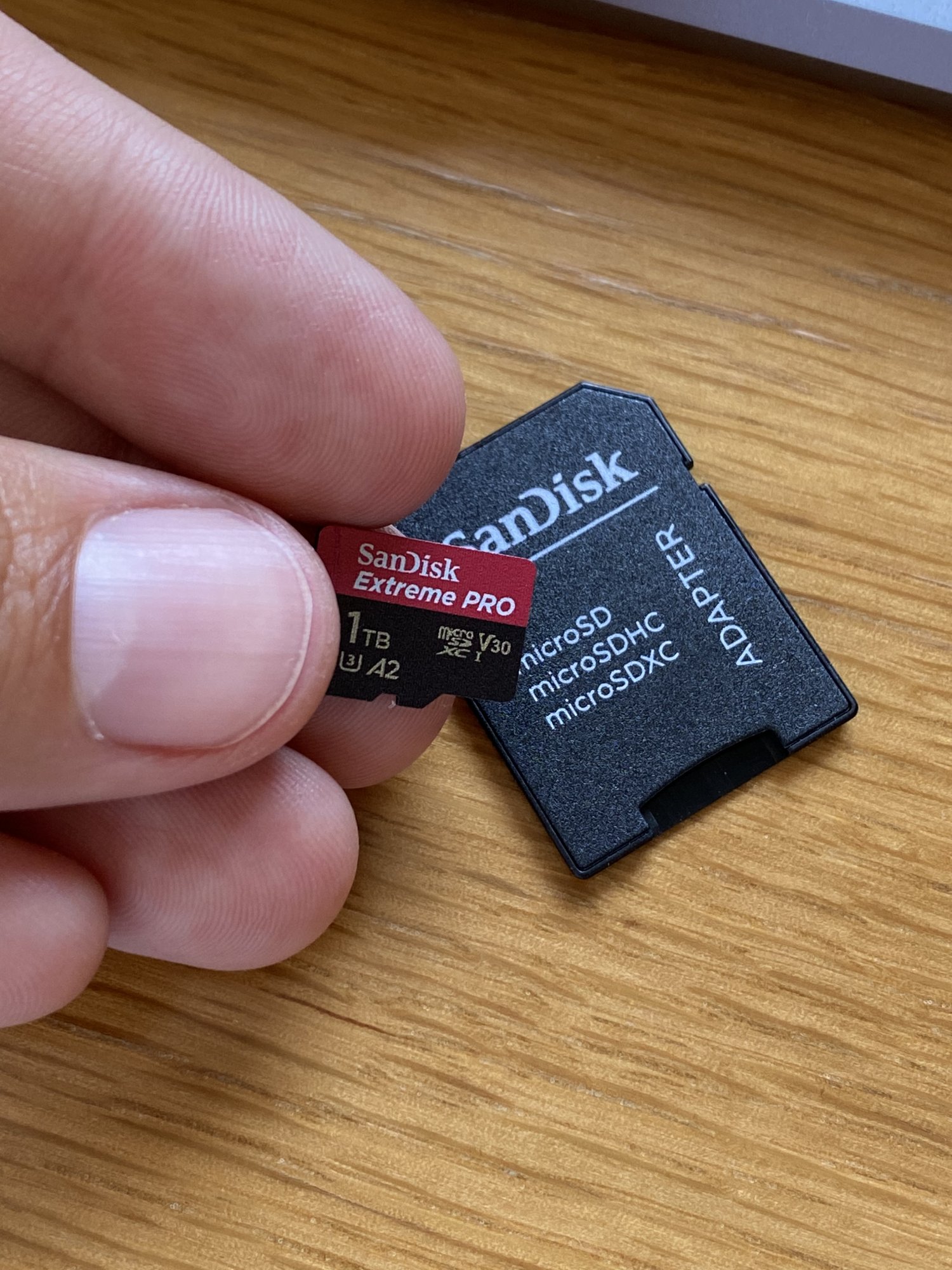

Me - my 4TB Seagate Backup Plus drive just died (the second one to die). Looking on Amazon, it looks like the one to get is the SanDisk 1TB Extreme microSDXC UHS-I Memory Card with Adapter - Up to 190MB/s, C10, U3, V30, 4K, 5K, A2, Micro SD Card- SDSQXAV-1T00-GN6MA. Currently $121. Slightly faster than another one that is up to 150MB/s, C10, U1, Full HD, A1, MicroSD Card - SDSQUAC-1T00-GN6MA. And couple it with the BASEQI UHS-II Aluminum microSD Adapter for 2021 M1 MacBook Pro 14 & 16” (Space Gray).
How is that Sandisk working out?
Is there a better option?

The fastest UHS-I card I have is a SanDisk Extreme Pro 128 GB, with a write speed of 78 MB/s, read speed of 90 MB/s. This pretty much shows that without the extra pins for UHS-II, 80/90 is likely the maximum speed you'll see. Multiple other reviews online show similar - 90-100 MB/s is the absolute fastest you'll see on a UHS-I card.
My SanDisk Ultra 1 TB has roughly equal read speed, but half the write speed. I have never seen a 1 TB UHS-II. So if you want maximum possible speed, 256 MB is currently the limit. If you want maximum possible capacity, you'll be limited to ~100MB/s.
