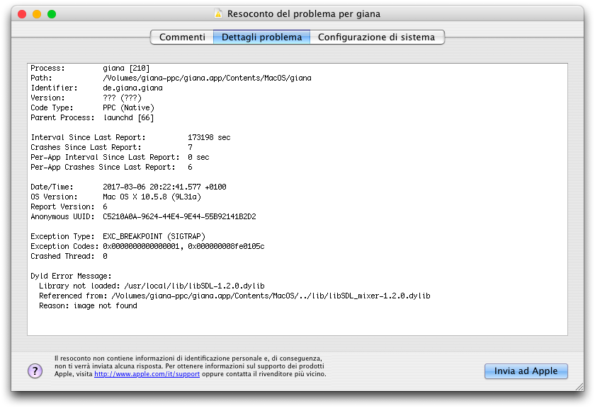

Hi to all! I have found a version of Giana Sisters for PowerPC Macs on this site http://www.gianas-return.de/ that is compatible with OS X 10.3+, but there is a problem: it crashes as soon as I open it. The error log says I need libSDL installed, but I don't know how to do it. I tried with Tigerbrew without success. Any suggestions, help?

After it crashes the system itself ask you if you want to know what error is... I opened this kind of log and it says I need the SDL library installed. Apart from this I also contacted the developer for a help and he said I need the SDL library too.

Thanks Lastic! I already tried it and unfortunately it didn't work.
Here's the error log:
Do you find these files in /usr/local/lib ?
Maybe your PATH doesn't include
this directory?
I'm away from home without PPC this week so can't help much
thanks for the tip Lastic, I got it working! The error log saiid that I missed the sdl library in the path usr/local/lib which is not accessible normally through the Mac finder. I had to type some commands in terminal to see those folders, and then I right clicked the "giana.app" file and clicked "Show package contents" and then I found the libraries and I copied them in the path. After doing that the game launches, and it loads until the screen in which I can choose the language by clicking on flags.. Doesn't matter which one I click, I have tried all the four languages, but after clicking on a flag it just closes, without a error, it just closes.
