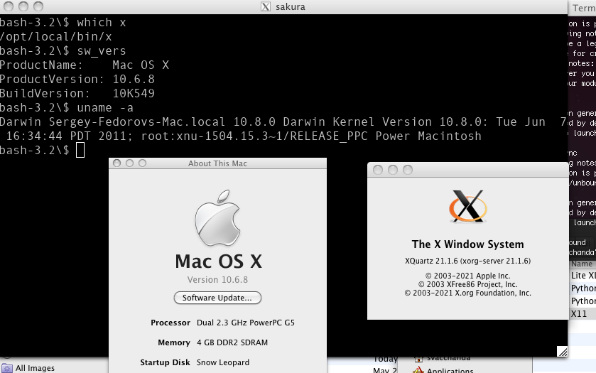

That does not make much practical sense. Keep in mind, I use 10.6 and 10.5, so no idea what 10.4 needs for curl.
You can do much easier then, rebuilding the base against its own curl. Just configure as `--with-curlprefix=/opt/local` and rebuild.
P. S. If you already have a tree in /opt/bootstrap, you may check what it wants with minimal curl:
