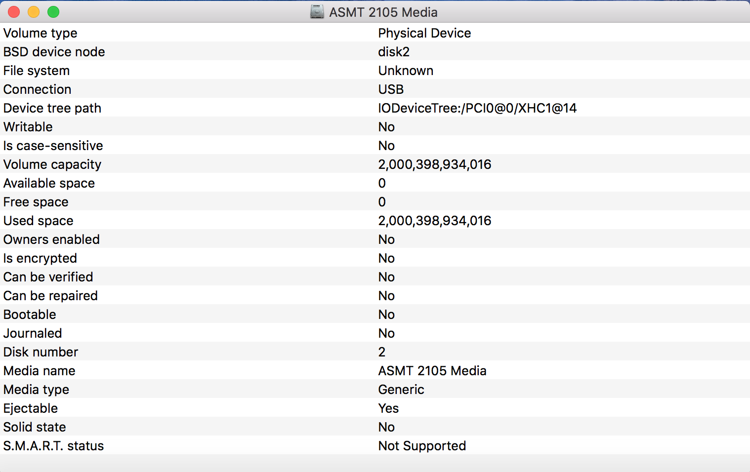

[doublepost=1458168575][/doublepost]The drive won't mount but disc utility sees it. Its labeled after the enclosure, not the drive name it used to have. I can hit get info and I see this: any clues here for you pros?
The drive was not full at all.

If only one of them worked. Tried on older OSX mac, same thing. Can't event repair the drive. When in DU it shows a 250gb section, which makes no sense as the drive is 2tb.
....sighhh...looks like hot glue is my only option to salvage the current drive. And hope my cloud backup drive arriving sometime I hope soon has all the data I need.
