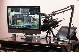

I hooked up an Cintiq 13" Tablet that I basically use as a display, but it also comes in handy as a drawing tablet. I like the small size for it saves space on the desktop, plus it's a good monitor when I do web design/development work. I don't have to keep flipping screens on my main screen and also it gives a different perspective on my website(s) for not everyone is using a 27" Retina display. Yes it basically plug and play just as long as you by an adapter cable to plug into the correct thunderbolt port.
