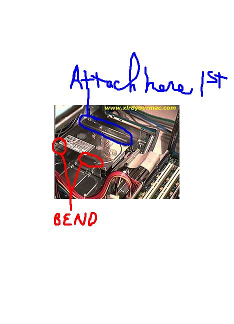

I'm trying to add another IDE hard drive to my Rev. 2 (Yay!) PowerMac G3 B&W. What perplexes me about the drive mount above the original master drive is that its wider than the drive I'm trying to add. Just how DO you install the second drive anyways? The Apple manuals aren't helping either.
You'll notice that one side of the drive bracket has two long metal tabs that are designed to bend towards the drive. Attach the drive to the other side first, then bend the metal tabs towards the drive and tighten the screws.
Which side? Bend those unattached tabs on the left? I feel odd bending a computer component to get it to work... Thanks to www.xlr8yourmac.com

Notice the picture...firmly screw the drive onto the side circled in blue. Then bend the two tabs circled in red towards the drive, and screw in firmly.

aquajet said:
Notice the picture...firmly screw the drive onto the side circled in blue. Then bend the two tabs circled in red, and screw in firmly.
Ok I get it. I bent them and it didn't seem so bad. 🙄
Thanks!
