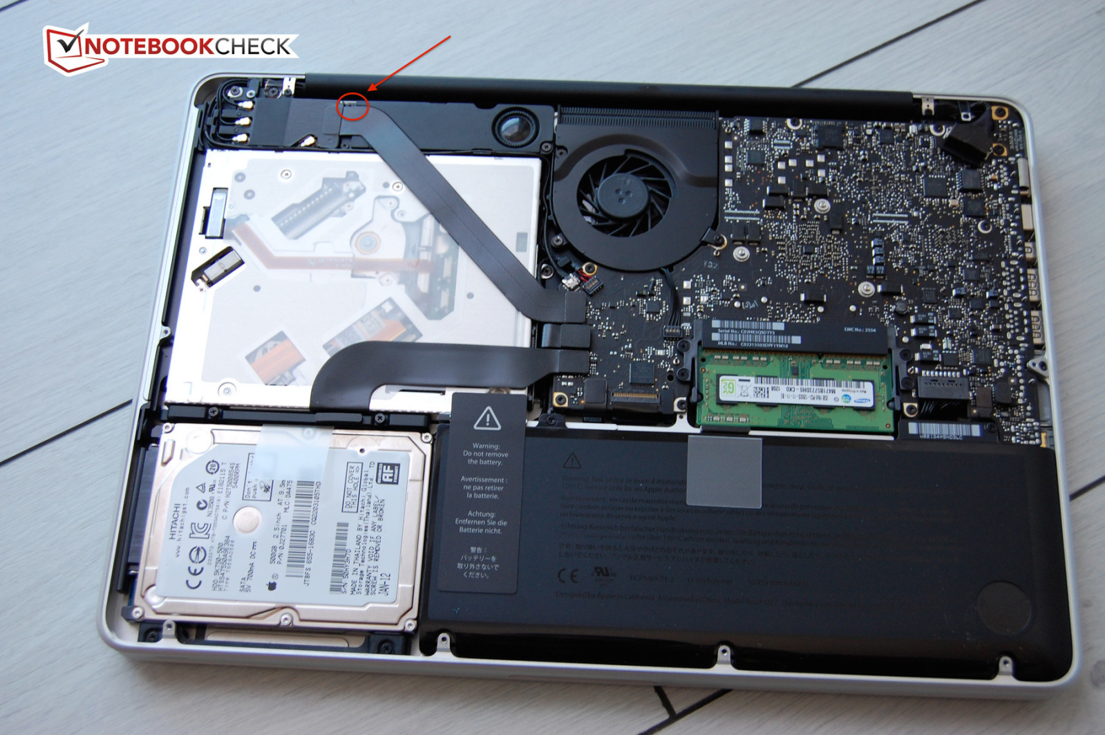

disk utility does not show anything. before opening again the mbp I'd like to know how to deal with a screw (circled in red).
When I went to put everything back together that screw caught on the black cable just underneath and as I would fasten the screw it would bring that black cable down, there is no space between the hole and that cable. I ruined a bit that cable trying to get the screw underneath it.
Is there a technique to avoid damages to that cable?

Pretty sure I disconnected the cable from the other, logic board, end and then that enabled me to lift the cable, angle it up and get the screw in underneath - but that is from memory nearly a year ago....

yeah the problem is that the screw is VERY near where the cable begins and that means I'd need to do a VERY TIGHT bend to it just where it starts, it's not ideal for it
