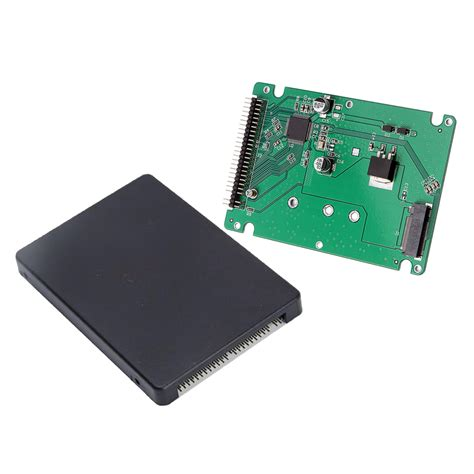

Fitting a 2.5-inch IDE-to-m.2 SATA SSD adapter, which are cheap and plentiful these days (as are the sub-128GB m.2 SATA SSDs), will be pretty straightforward.
They basically look like this (the piece on the right is just the piece on the left, without the black cover):
iu

And of course it's IDE, so can put a SSD aswell in it.
But I do have problem with Wallstreet/PDQ recognizing 2.5-inch IDE-to-m.2 SATA SSD, maybe it's the certain brand I used, or a matter of slave/master setting that I don't know how to solve...
I use that exact same adapter in my Titanium and it works great.

Hi, no ! No special config issues at all.. There is a pic in this thread that shows you what you need. What powerbook do you have ? I have a Titanium G4 1GHZ and Pismo. This is what you need.
Pismo and Titanium are not the same animals as the Wallstreet/PDQ.
These last are much more picky about what SSD adapters you put in them.
I have the one posted above, it was never recognized on mine. Again it may depends on the brand or the Slave/Master settings, some of these adapters don't include a ways to change these setting... And I ended up using IDE to CF adapter.
Better check for one known working specifically on Wallstreet/PDQ .
There are some threads about that in this forum.
