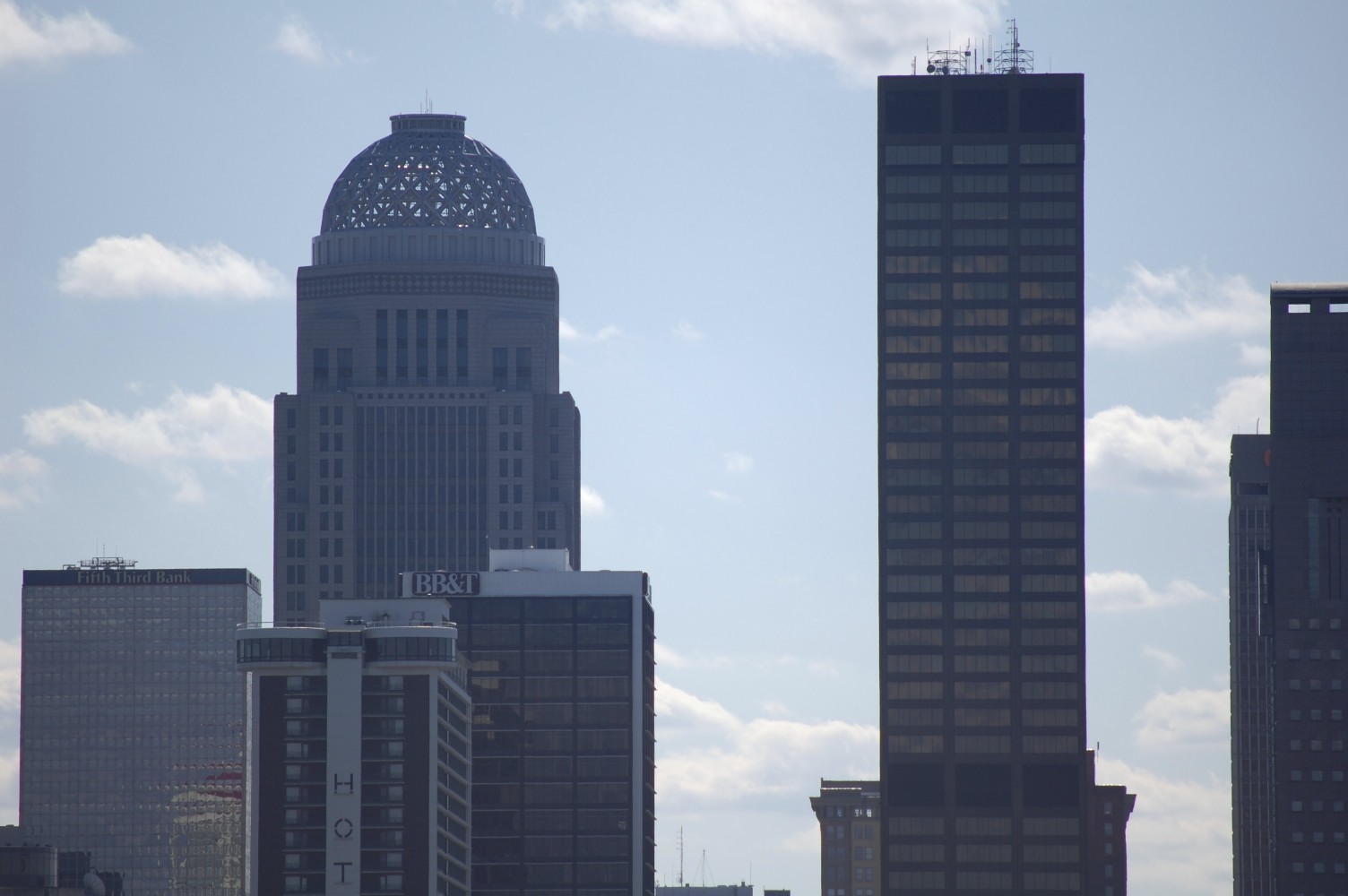

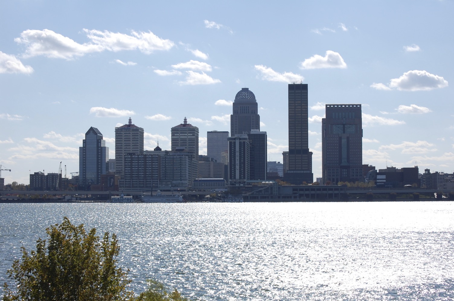

I also recently purchased a D40 and I did buy the 55-200mm VR lens that you mentioned, so I can at least show you what the lens can do (if I can figure out how to attach the photos).
These were taken from the Indiana border looking at Louisville, Kentucky across the Ohio River. I would guess the buildings are about a mile away or so. The first image is the lens set to 55mm and the second is the lens set to 200mm while focusing on the two tallest buildings. Personally I am pretty happy with it and would have no problem recommending it.
I have not picked up the 50mm/f1.8, but I have looked at it. If you do go that route I would love to hear your opinion on it.
