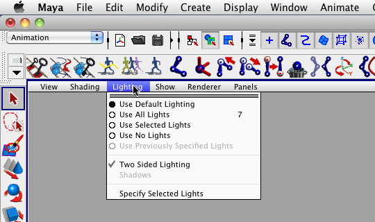

Howdy,
How do you create a secondary menu bar inside a window?
Like this:
Adios,
Cactus Dan

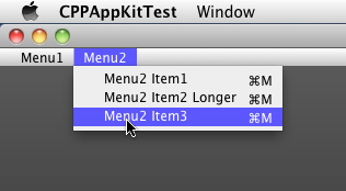

Howdy,
Hey thanks for steering me in the right direction. I've actually got it working nicely:
It works pretty much just like the main menu bar. ;)

Howdy,
Well, actually, I did that using C++/Objective-C++ without any nib, for the CPPAppKit project I've been doing as an experiment. It is really quite complicated, as I created my own c++ menu classes. Initially I tried using the NSMenuItem and NSMenu classes for the drop down menus, which did work, but I didn't like the results. I wanted them to have squared corners, and also wanted the possibility of adding background color.
But basically, the menu bar and menu item are wrapped to an NSView and the drop down menu is wrapped to an NSPanel. The menu item has subviews of NSTextView. If its a menu bar item then it only has one text subview for its title, and if its a sub menu item then it has 3 text subviews, one for the check mark, one for the title and one for the hot key list. The classes do their own event handling.
The whole project is mostly C++, with minimal Objective-C++ wrappers to communicate with the AppKit framework. I don't know if the code would be of much help if you're strictly working in Cocoa Objective-C but you're certainly welcome to it.
