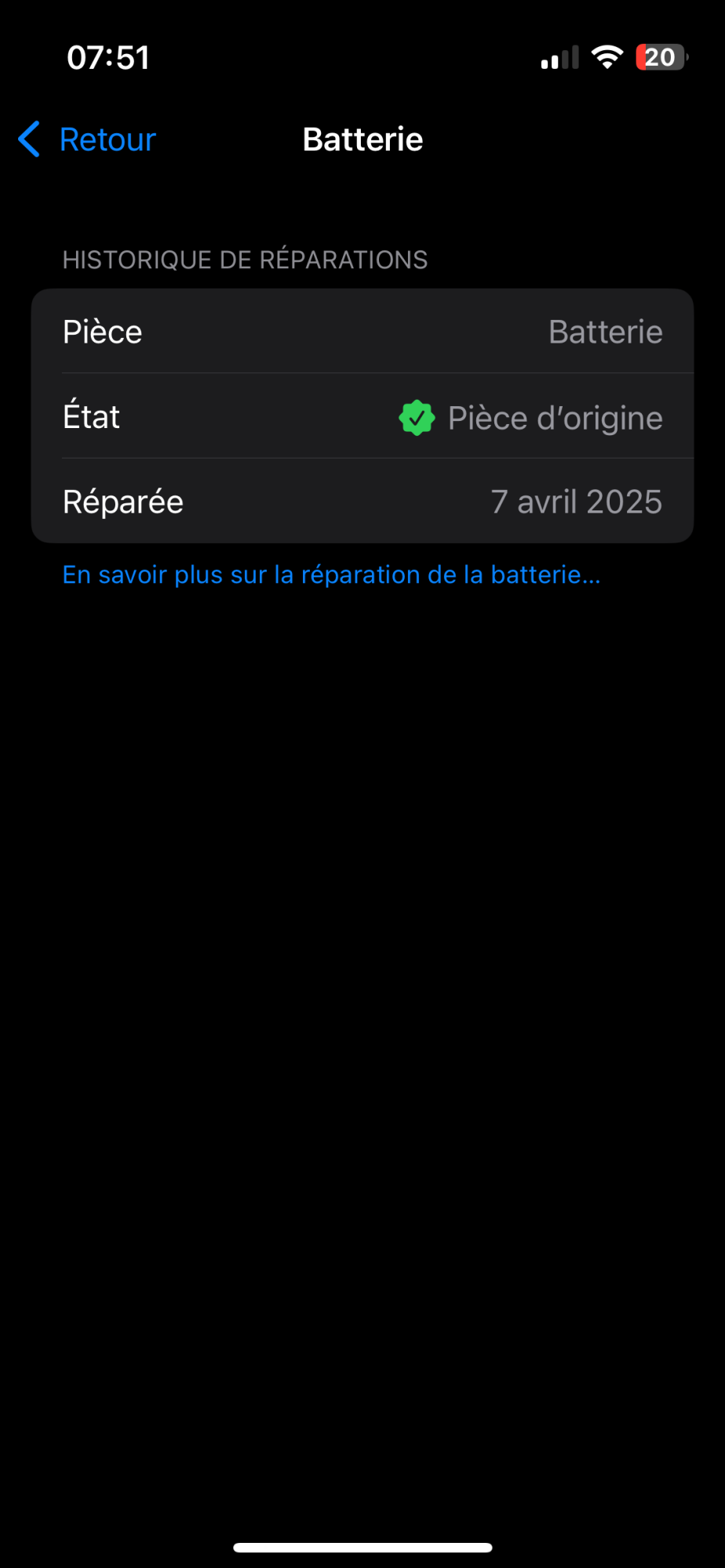

I bought a reconditioned 13 mini that the BMS had and modified to display 100%. The battery was at 85% for 354 cycles. 🤬
I sent it to Apple to replace the battery (by mail).
They did it without a problem and sent me the iphone with a new battery. 👍

The analytics files gave me the actual Battery Health and Cycles values.
It's something I've been monitoring on various forums for months.
BlackMarket sellers, Amazon, ebay all sell iphones at Premium $$$ with the BMS modified to 100% BH. This is a three-stream scam. 🤬
For the time being I have never seen a scammer reset the number of cycles. Never !
I think so they can't do it.
As I mentioned my BMS had ete modified (so iphone unlocked) and yet Apple replaced my battery with no problem.
So yes your battery is not new.
But it has the advantage of being an Apple battery with 0 cycles.
I guess you shouldn't worry. 🙂
