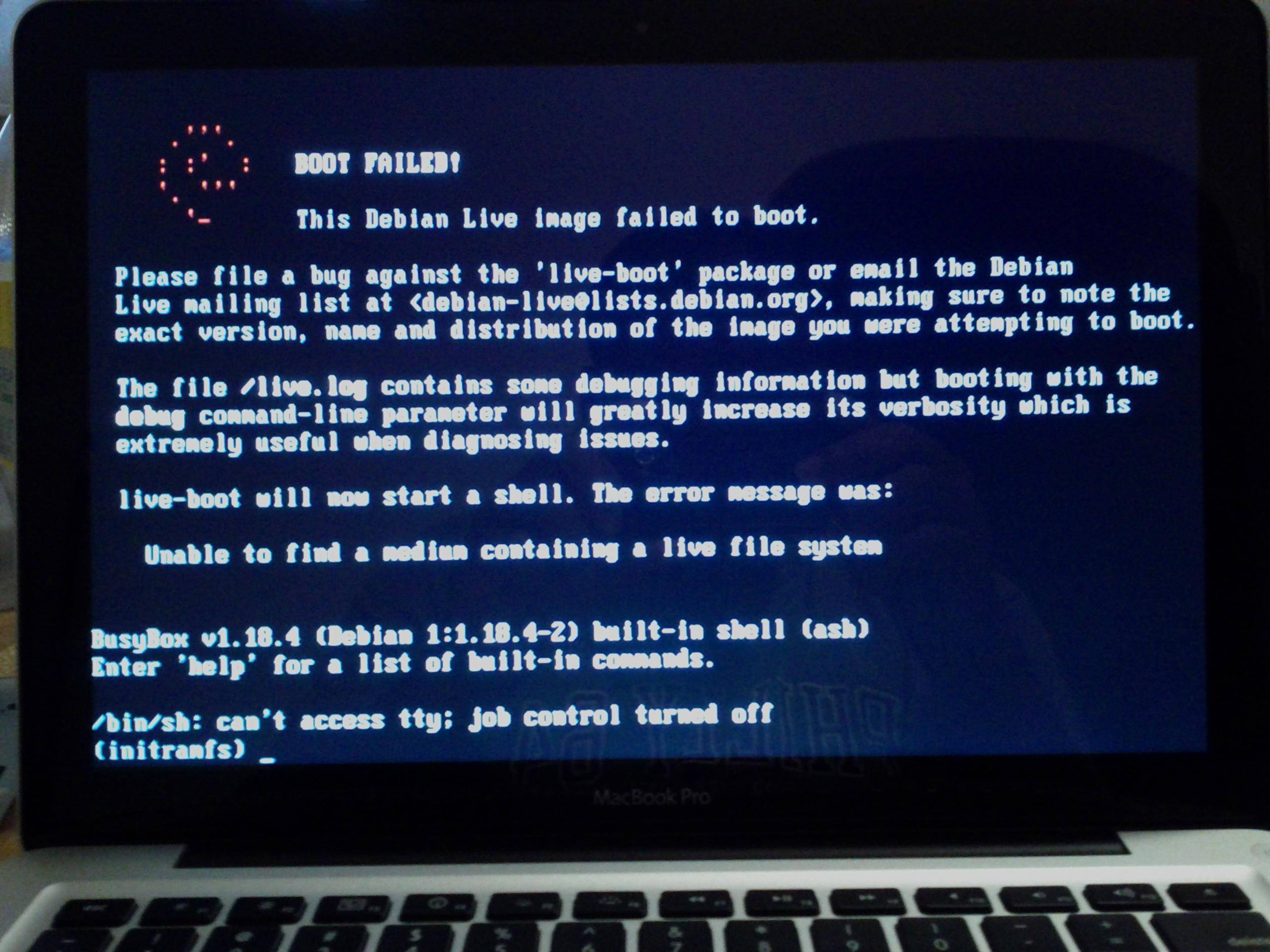

Hey guys.. I'm trying to wipe my my ssd again, but I can't boot into gparted for some reason.. keep getting a error message.. this is on a 2011 MBP 13 vs the 2010 some months ago
Sent from my Nexus S 4G using Tapatalk
