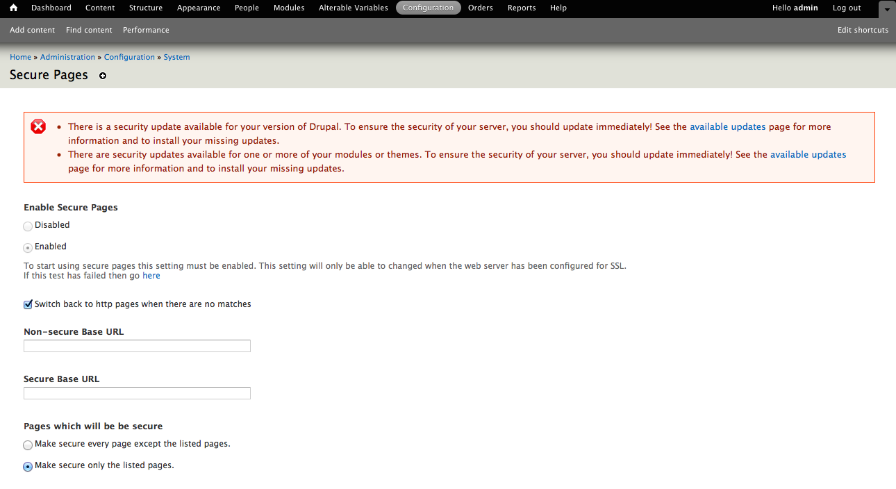

So when I log in as admin, under the "Configuration" and "System" Tabs... I see the following page.
Has a option for "enabled" and "disabled" for secured pages. It is currently set to "enabled." However, it does not let me select "disabled." Is this the right area for me to turn off references to secure pages... and if so how do i get it to let me disable it?
I've never used Drupal, but I'm guessing that controls whether or not it references https vs http links within the CMS, so I would assume you would use that interface to disable "secured pages". As far as why I won't let you disable in that context, you'll probably need to check the support documentation.
And that warning in the header about a security update should probably be addressed.
I cant figure out a way to let me switch it to disable secure pages. However, further down in the controls is a box where you can specifically list which pages to make secure, and I removed those listed. Works ok now.
