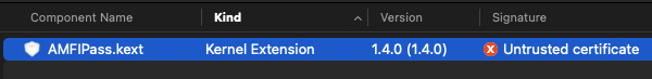

OCLP is not entirely open-source. As far as I know, the code for the AMFIPass kext in not public.
“Implement AMFIPass system
Removes need for disabling Library Validation and AMFI outright on all applicable systems”
https://github.com/dortania/OpenCore-Legacy-Patcher/blob/main/CHANGELOG.md
The AMFIPass-v1.4.0-RELEASE.zip version https://github.com/dortania/OpenCor...Kexts/Acidanthera/AMFIPass-v1.4.0-RELEASE.zip
is signed with an Untrusted certificate.
