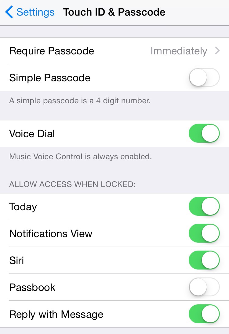

Sorry for the belated response. You'll find it in Settings > Touch ID & Passcode.
Sorry for the belated response. You'll find it in Settings > Touch ID & Passcode. Image
Right, that's the setting to allow it to be used on the lock screen. So once that is enabled, and you are on the lock screen, what did you do to bring up Siri there?
I held down the home button, which leads me to believe you guys are most likely correct; I'm using a finger that I've enabled for Touch ID, so that may be the case.
However, I had someone I know who uses 8.3 try the same thing and it didn't happen. They may have been using a different finger.
Sorry for the misunderstanding, by the way. I thought you were asking how to activate Siri for use on the lock screen. My brain isn't fully functional today.
